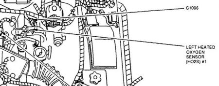

what does the bank 2 sensor 1 do on this car and where does it go?

DESCRIPTION The Heated Oxygen Sensors (HO2S) are located in the dual converter Y pipe below the exhaust manifolds and below the catalytic converters. OPERATION The heated oxygen sensors react with the oxygen in the exhaust gases and generate a voltage based on this reaction. *A low voltage indicates too much oxygen or a lean condition. *A high voltage indicates not enough oxygen or a rich condition.
https://images.2carpros.com/forum/automotive_pictures/12900_os_5.jpg
The Left Heated Oxygen Sensor (HO2S) # 1 is located in the lower LH rear of the engine, in the exhaust manifold.
