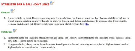

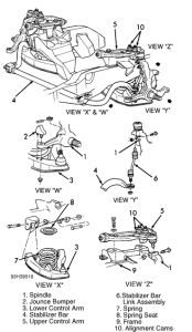

My husband, unwilling to ask anyone ?s (lol), is having a hard time trying to fix the upper ball joint, and stabilizer joint in our car. Can you please let me know how? thanks!!!
