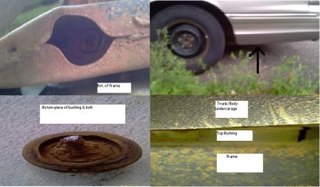

1994 Ford Crown Victoria V8 Two Wheel Drive Automatic 179xxx miles
A bushing and bolt fell out of my frame on the rear of the car, i belive it holds the chassis to the frame. I was trying to find how to replace it in my chilton and cannot seem to find it. I also looked at rockauto.com & orilley to find the part but cant seem to figure out what its called.

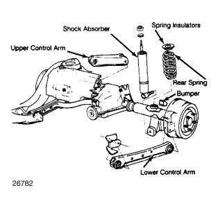

Hi See diagram is it lower or upper control arm? Advance Auto has bushings

That's not it. Heres some pictures of what im talking about. there is a hole in the bottom of the frame trunk side of axle) for access to where the piece goes, it goes through the top of the frame into part of the trunk/body. there is the other piece of bushing still in place.

That is the body bushing. Call local dealer for part number or go to www.motorcraft.com and search the part. We have to buy ours from the dealer. There are different bushings in the frame also. If you loosen the other bushings on the same side, you can raise the body enough to replace the bushing. The Ford part might be called a body isolator.
