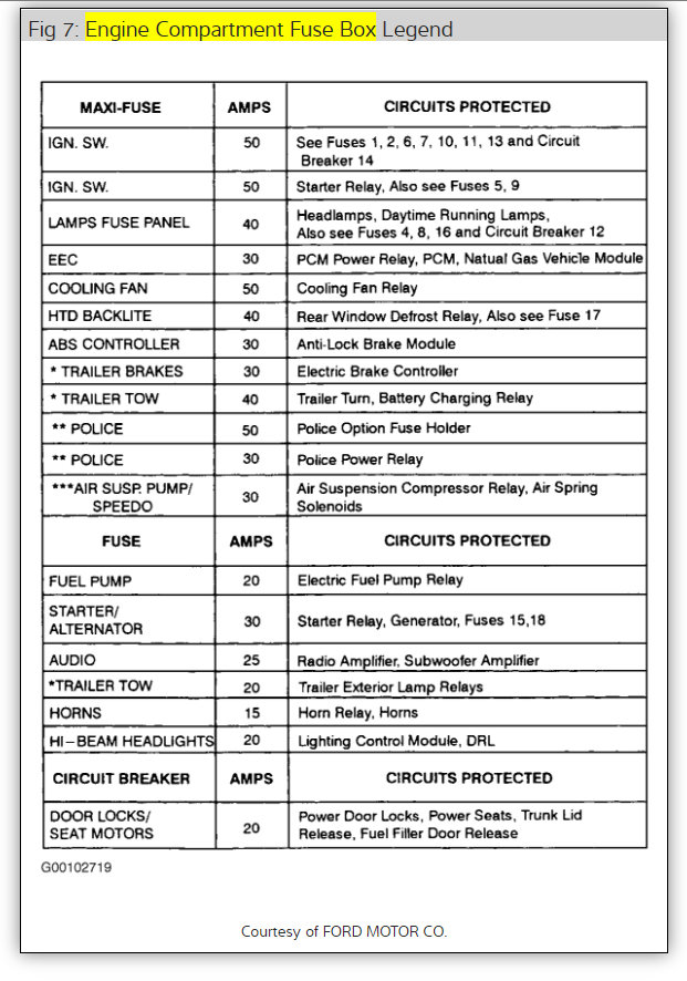

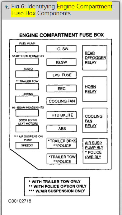

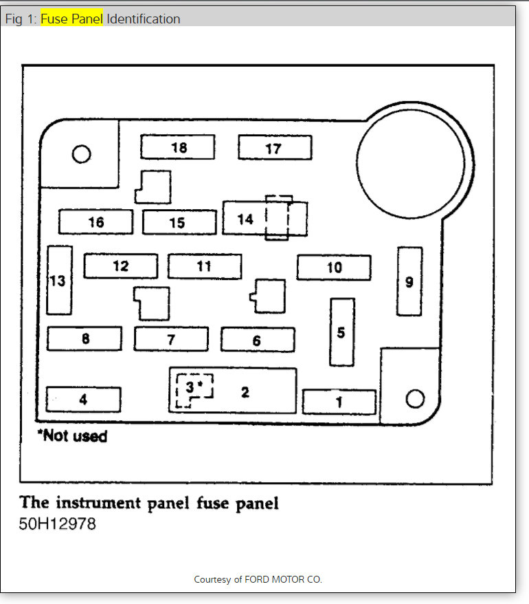

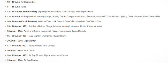

I have looked all over the internet and can not find any diagrams for my 93 crown vic fuse box.. Both for the power distribution box and for the fuses underneath the steering wheel.

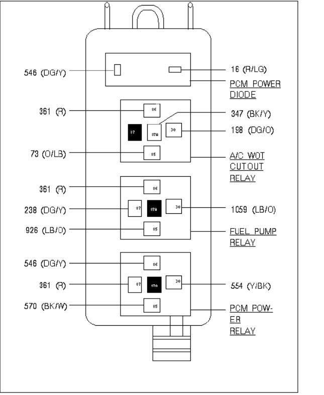

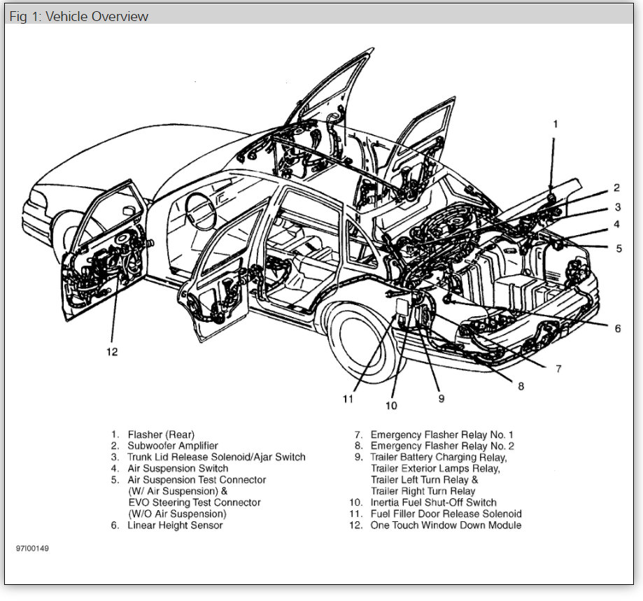

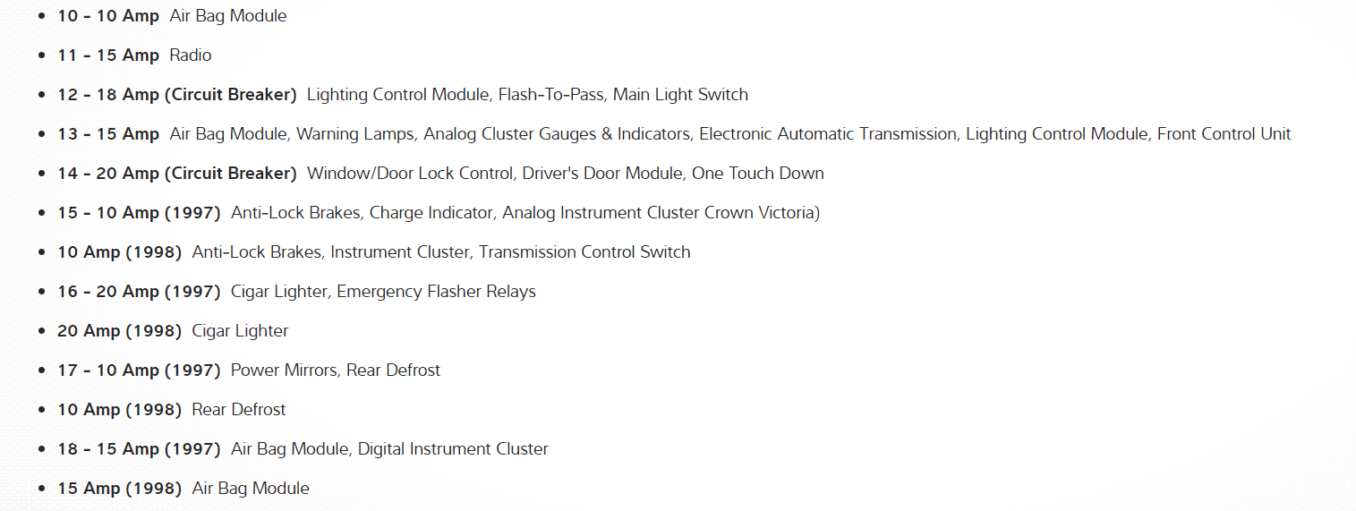

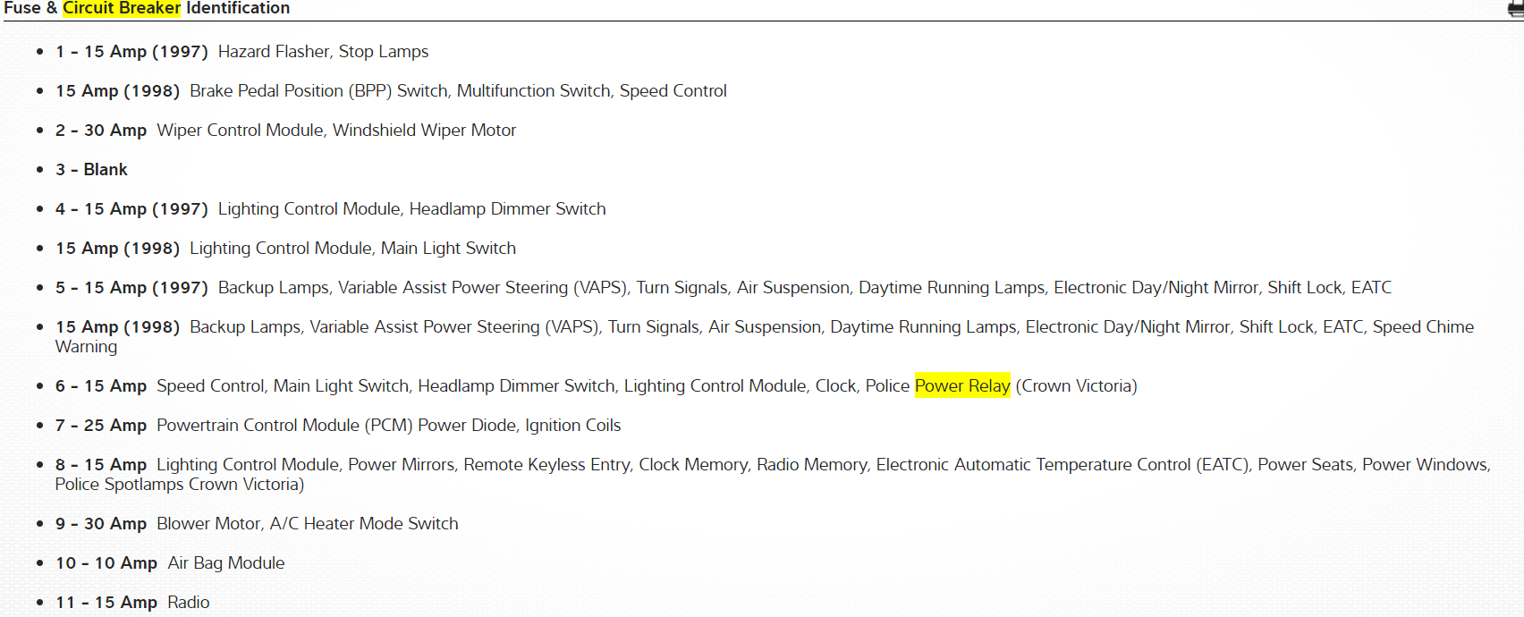

Here is a guide to help you test the fuses for power with the fuse panel location and identification below.
