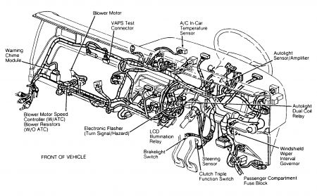

trying to find where the flasher module is located on the car. I checked the fuse panel and it is not there.

behind instrument panel, to the right of steering column
https://images.2carpros.com/forum/automotive_pictures/261618_Graphic_569.jpg
