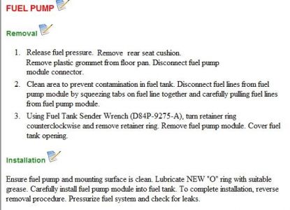

DAVE H
  • 13,384 POSTS
FUEL PUMP
Removal
Release fuel pressure. See FUEL SYSTEM PRESSURE RELEASE . Remove rear seat cushion. Remove plastic grommet from floor pan. Disconnect fuel pump module connector.
Clean area to prevent contamination in fuel tank. Disconnect fuel lines from fuel pump module by squeezing tabs on fuel line together and carefully pulling fuel lines from fuel pump module.
Using Fuel Tank Sender Wrench (D84P-9275-A), turn retainer ring counterclockwise and remove retainer ring. Remove fuel pump module. Cover fuel tank opening.
Installation
Ensure fuel pump and mounting surface is clean. Lubricate NEW "O" ring with suitable grease. Carefully install fuel pump module into fuel tank. To complete installation, reverse removal procedure. Pressurize fuel system and check for leaks.
Oct 27, 2017 at 7:41 AM (Merged)

DAVE H
  • 13,384 POSTS
Removal
Tips Click a link to view tip
J PlaterQuestion: sending unit removal
Release fuel pressure. See FUEL SYSTEM PRESSURE RELEASE. Remove rear seat cushion. Remove plastic grommet from floor pan. Disconnect fuel pump module connector.
Installation
