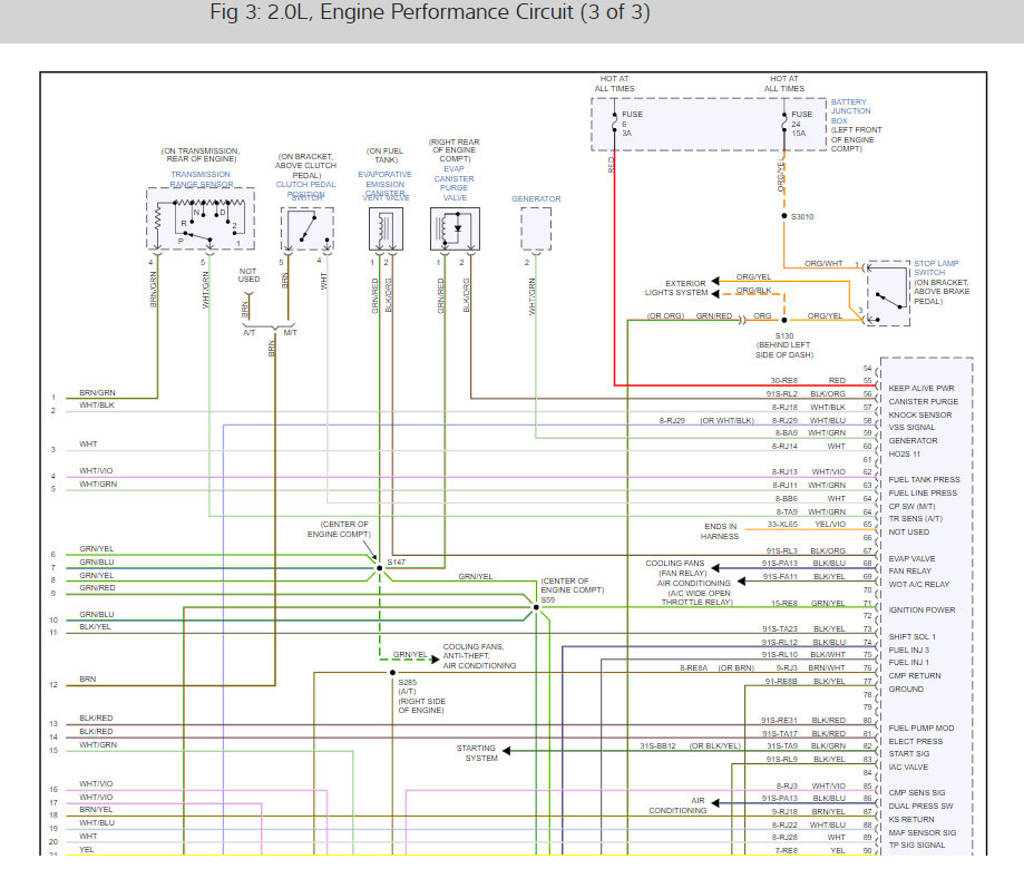

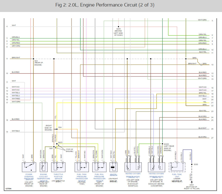

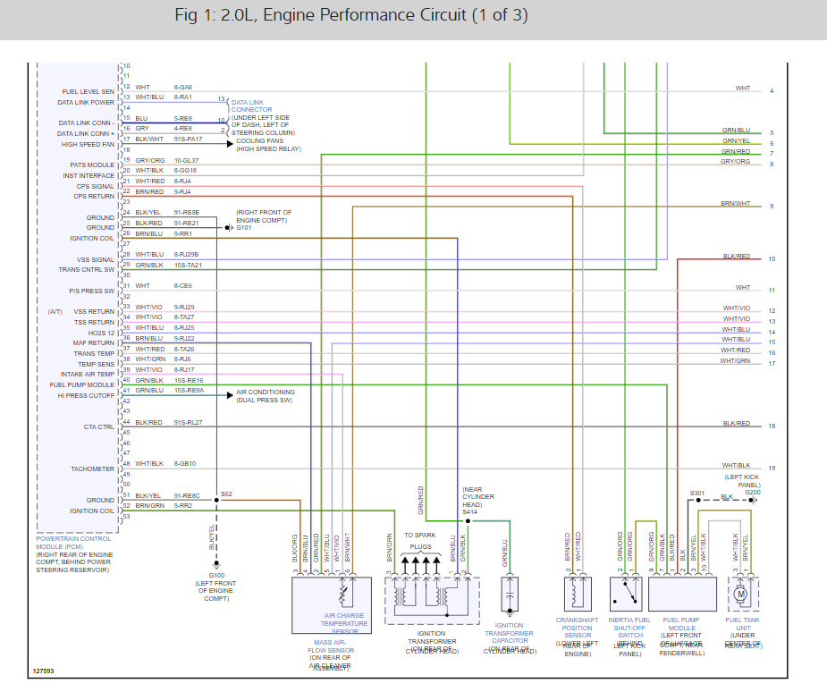

hi . when l drive this car first l start the engine starts good but it takes like 5 min and gas shut off the car get off, but if l push the gas pedal ready to drive the car dont get shut off the problem is when l stop in a red light the car starts shaking and sometimes the fuel stops or it has a problem with the pressure. The wiring or inertia switch?
Aug 20, 2010 at 1:02 PM
WRENCHTECH
  • 20,761 POSTS

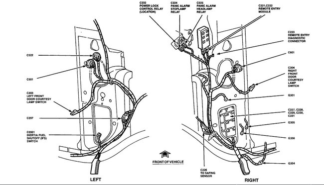

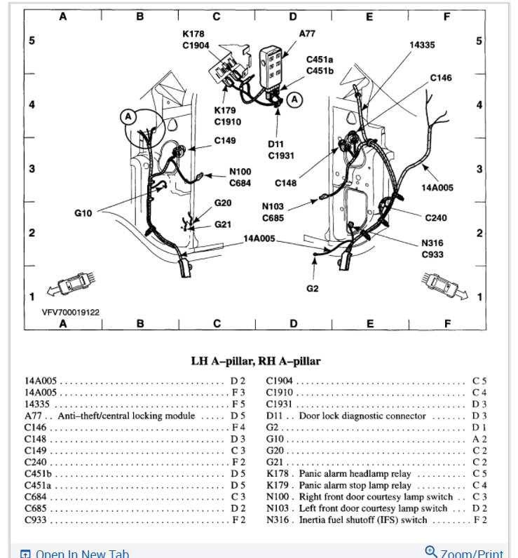

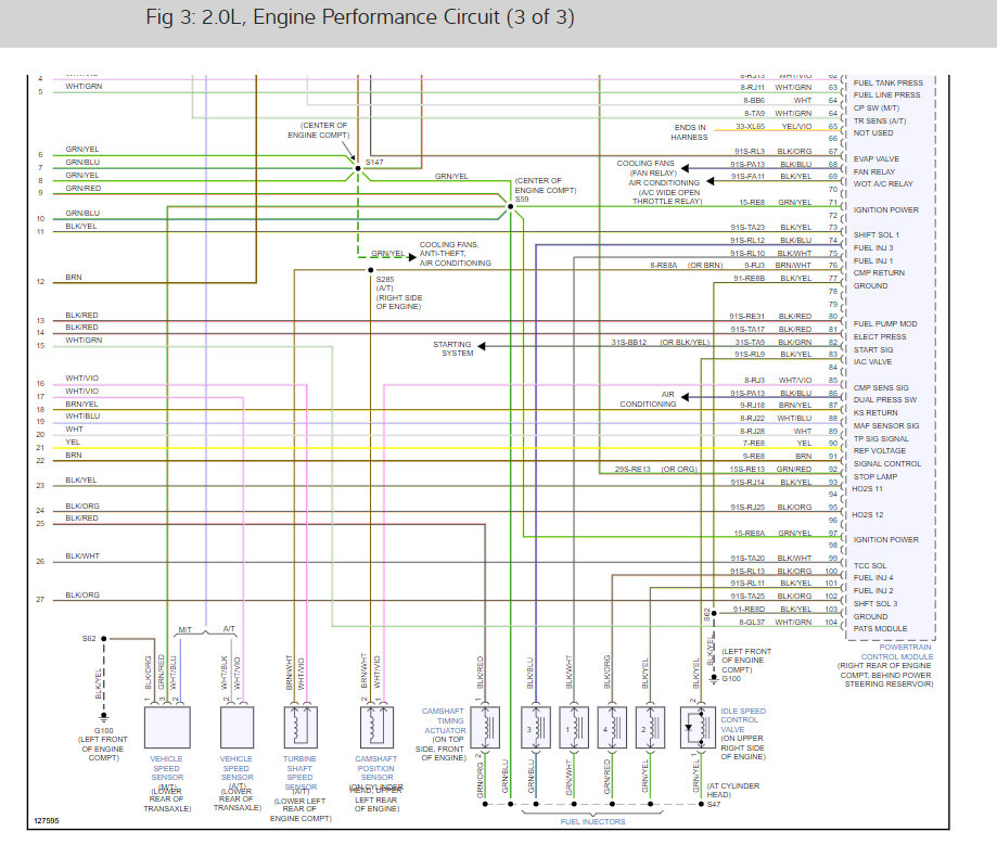

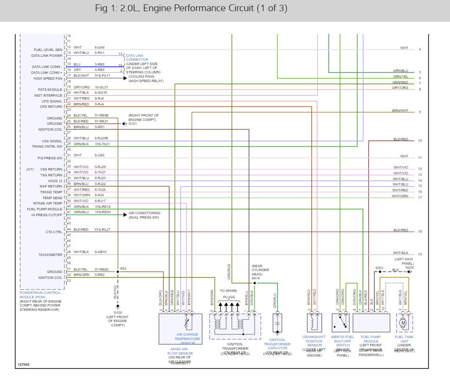

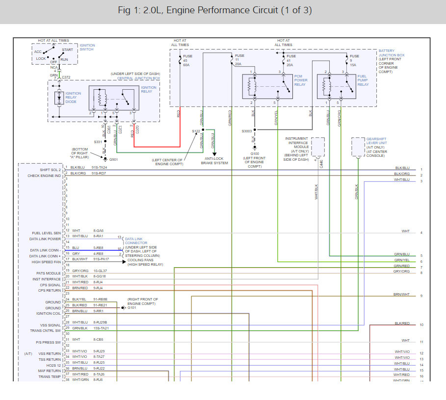

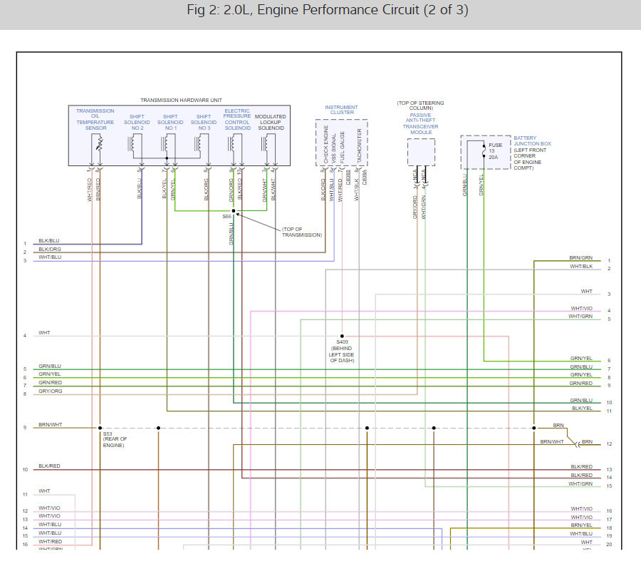

It could be both but to be sure here is the fuel pump and engine wiring so you can see how the system works with the inertia switch location as well. Check out the diagrams (Below). Please let us know what happens.
Aug 20, 2010 at 1:38 PM

The inertia fuel shutoff switch is located behind the left cowl side (kick) panel. Access to the switch is through an opening in the trim panel.

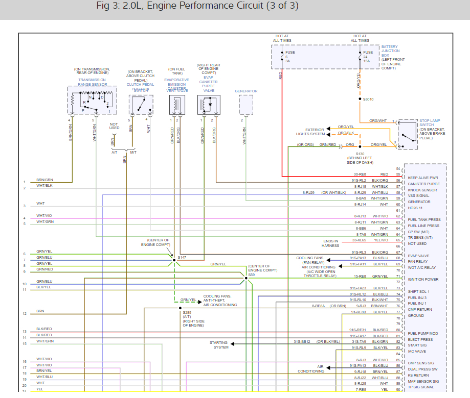

fuel pump shut off switch triggered,how do i reset?
Aug 29, 2020 at 11:22 AM (Merged)
  • 110,194 POSTS
On a ford, it is nothing more than a reset button. I believe the contour has one in the Left kick panel (Drivers side by your feet)
See diagram below
