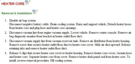

I need to know how to fix my heater core, im retarded and dont know how. can you send me a picture or step by step instructions on how to fix it

https://images.2carpros.com/forum/automotive_pictures/261618_Noname_1409.jpg
