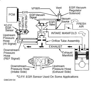

i recently fail a smog test due to egr. i replaced the egr valve the egr exaust gas pressure differential sensor. how do i clean out the whole exaust system?

What was the code ?
most I ve seen DPFE sensor no good
also check for clogged intake manifold side of the egr
check for an leaks also
good luck

the code was p0401 insufficient flow to the egr

https://images.2carpros.com/forum/automotive_pictures/99387_Graphic2_203.jpg
