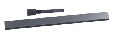

May I suggest spending $20 and buy a tool kit OTC Tools OTC6486 Ford Cam Tool Kit do it right with the right tool less headache for you good luck

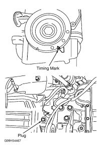

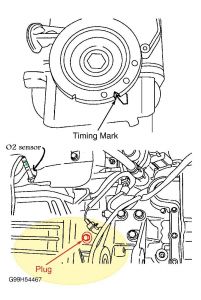

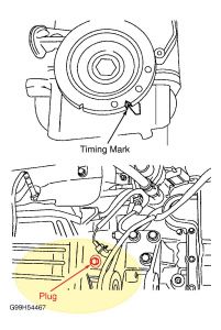

Where is the hole the bolt from this kit fits into? I could use some direction here? Is it near the fly wheel, crank pulley or under a cylinder? Thanks Eddy

https://images.2carpros.com/forum/automotive_pictures/99387_Untitled_6.jpg
https://images.2carpros.com/forum/automotive_pictures/99387_Untitled_7.jpg

Rotate the crankshaft clockwise to TDC cylinder No. 1. Remove the blanking plug, completely screw in the Crankshaft TDC Timing Peg (303-574, T97-P6000-A), and auto-align the crankshaft to TDC. See Fig. 10 .
https://images.2carpros.com/forum/automotive_pictures/266999_plug_1.jpg

Hello again I'm not understanding the whole cam kit. I machined a flat piece of steel to keep the cams aligned. But the bolt has me at odds. Does it prevent the crankshaft from moving once properly aligned? Will I still need to jam the flywheel with a prybar? Thanks Eddy
Dec 19, 2008 at 12:49 PM
BMRFIXIT
  • 19,053 POSTS
This is why you need to buy the kit
the bolt is measured to make contact and hold the crank in place
Dec 19, 2008 at 1:06 PM
DAVE H
  • 13,384 POSTS
both pieces of kit will hold crank and cam in place
