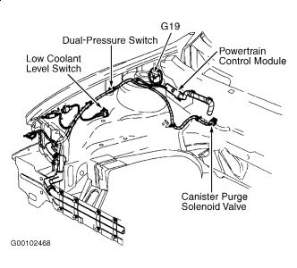

how do i remove my ecm

Powertrain Control Module (PCM)In right rear corner of engine compartment, behind power steering reservoir.
https://images.2carpros.com/forum/automotive_pictures/99387_Graphic2_201.jpg
POWERTRAIN CONTROL MODULE Removal & Installation Disconnect negative battery cable. Remove any component necessary to gain access to PCM. Loosen PCM connector retaining bolt (if equipped). Unplug harness connector from PCM. Remove 2 PCM mounting bolts. Remove PCM cover and PCM. To install, reverse removal procedure. good luck
