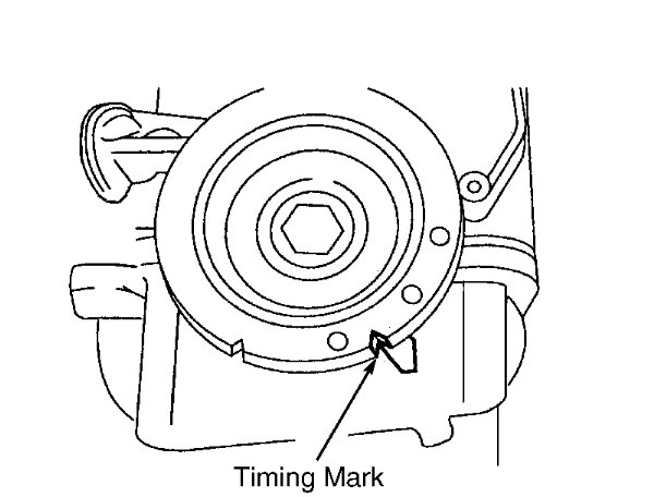

I need step by step instructions to replace the timing belt on my 98 ford contour it is 2 wheel drive automatic w/ 4 cylinder twin cam engine

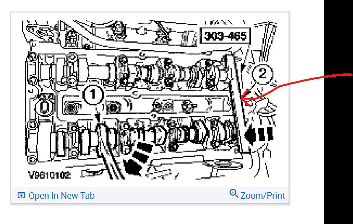

So there is a tool or bar that plugs into the rear of the camshafts and then you set the crankshaft at TDC, please check the images below to see what I mean.
CAUTION: The maximum amount by which the engine management system will adjust the camshaft timing (VCT control unit) is limited to two degrees.
As a result of this an extremely high degree of accuracy is required for any work which affects the valve timing.

3. Remove water pump pulley. Remove serpentine belt idler pulley. Using access hole in bottom of transaxle case to stop rotation of engine, remove crankshaft pulley/vibration damper.

9. Remove the spark plugs. Turn the engine to TDC on cylinder No. 1. To remove the tension on timing belt, unscrew the timing belt tensioner bolt (1) 4 turns. Position the tensioner so the locating tab (2) is at approximately the 4 o'clock position. Line up the hex key slot (3) in the tensioner adjusting washer with the pointer that is located behind the pulley.
CAUTION:To achieve proper tension when installing timing belt, camshaft sprocket bolts must be loose enough to allow sprockets to turn freely on the camshafts.
10. Remove blanking plug (1) from center of exhaust camshaft pulley. Loosen, but do not remove, exhaust camshaft sprocket bolt (2). Loosen, but do not remove, intake camshaft sprocket bolt (3). Remove timing belt.
