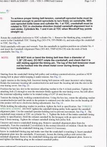

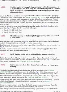

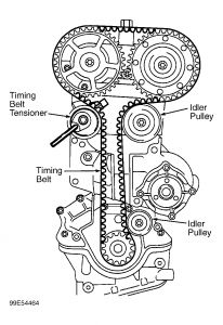

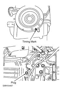

can someone tell me step by step how to aling the 2 cam shaft sprokets for the timing so that the valves should open and close the way they should so that the engine will run properly. Thanks Andy

Ok here are some pics as to how it should look and step by step installation. Now you will need to have a manual to give you proper torque procedure of the belt tensioner and a cam sprocket holding tool too. First is of the crank the other is of the whole thing and last will be the step by step. You will need to save pic and print so you can make it large enough to read.
