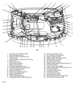

where does it go and how do you change it
Nov 12, 2008 at 5:28 AM
DAVE H
Experienced Mechanic
13,383 POSTS
it's on the rear of the transaxle under the hood .take the wire connector off unscrew fron trans and screw in new one .. reconnect wire's
