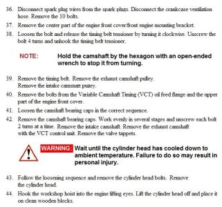

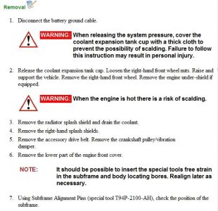

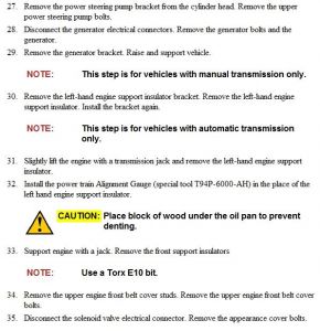

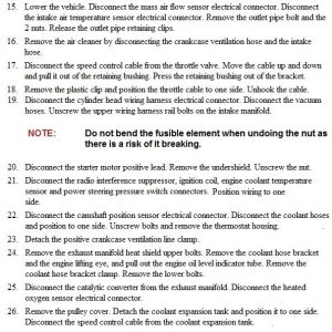

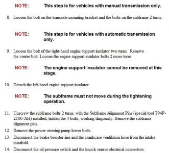

We have taked every bolt off the intake and exaust manifolds that we can see, do we have to take off the altinator as well?
Saturday, May 15th, 2010 AT 9:53 PM
BLUELIGHTNIN6
MECHANIC
16,542 POSTS
-1
Saturday, May 15th, 2010 AT 10:00 PM
