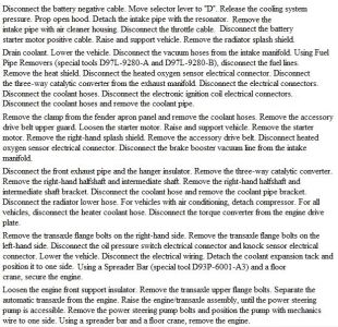

how do you get torque converter bolts off so i can remove enging

https://images.2carpros.com/forum/automotive_pictures/261618_Noname_2065.jpg
