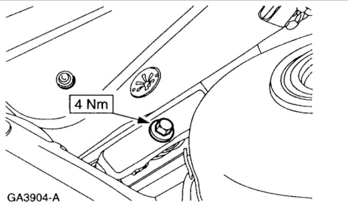

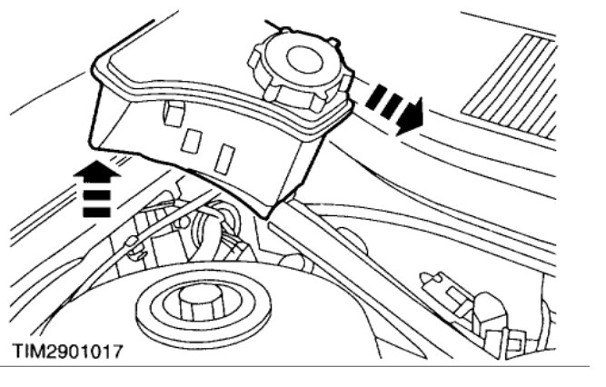

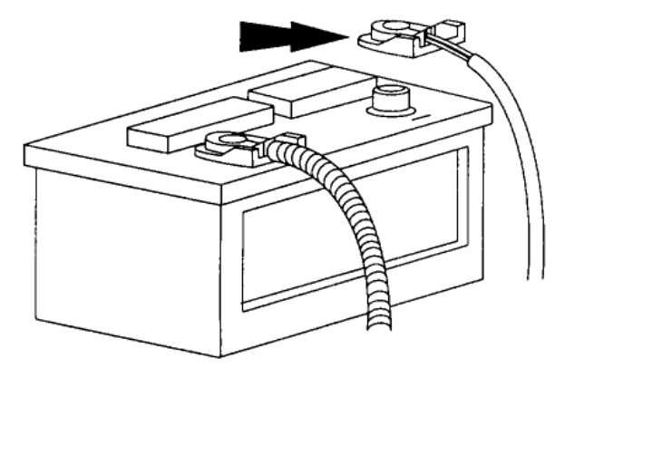

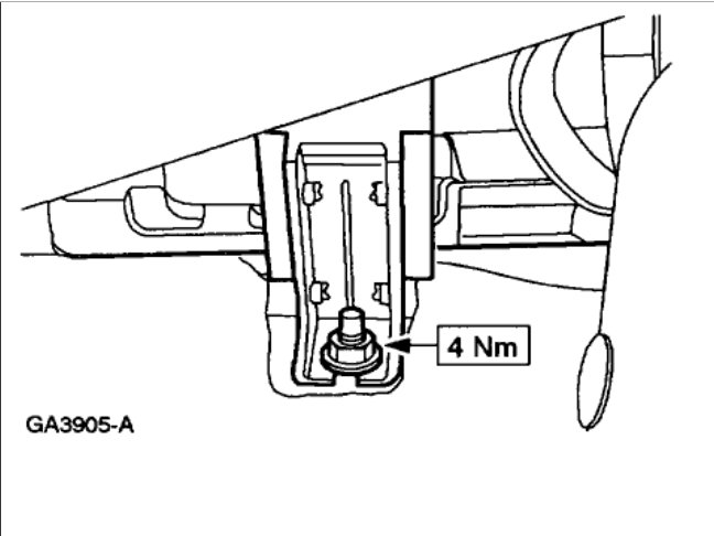

Where do I find the Engine Control Module (ECM) on my Ford Contour and how to replace.
Jul 24, 2009 at 12:35 PM
  • 55,224 POSTS
The ECM is located under the fluid reservoir. Here are some diagrams (below) that will show the exact location.
