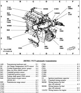

where do i find the camshaft position sensor
Sep 14, 2010 at 8:07 AM
  • 75,992 POSTS
Camshaft position sensor located @ B41-see below:
https://images.2carpros.com/forum/automotive_pictures/12900_c_29.jpg
