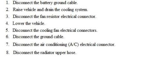

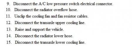

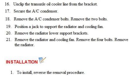

Engine Cooling problem
1998 Ford Contour 4 cyl Front Wheel Drive Automatic
how to replace the radiator.
Wednesday, June 2nd, 2010 AT 12:00 AM
BLUELIGHTNIN6
MECHANIC
16,542 POSTS
SPONSORED LINKS
Wednesday, June 2nd, 2010 AT 1:49 AM
