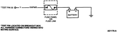

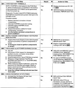

a friend of pull a code will did not under stand the code is internal control module keep alive memory(kAm) error.where is this and do we fix it? is this the pcm somebody said that we would have to get it flash . to do this would we just carry the pcm or the whole car thank you.

what are the code numbers?
Mar 18, 2010 at 10:42 PM
MICHAEL LEONARD 62422
the code was 0603 ya have great help thank you
Mar 19, 2010 at 2:49 AM
SERVICE WRITER
  • 9,123 POSTS
https://images.2carpros.com/forum/automotive_pictures/30961_a2_2.jpg
https://images.2carpros.com/forum/automotive_pictures/30961_a21_1.jpg
