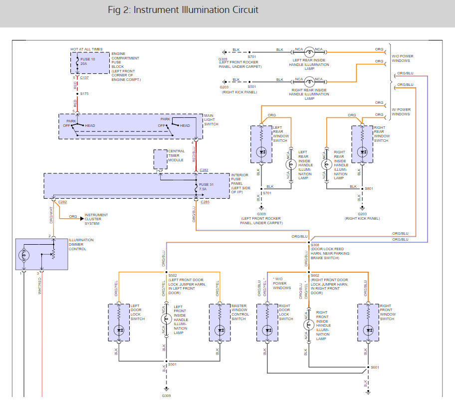

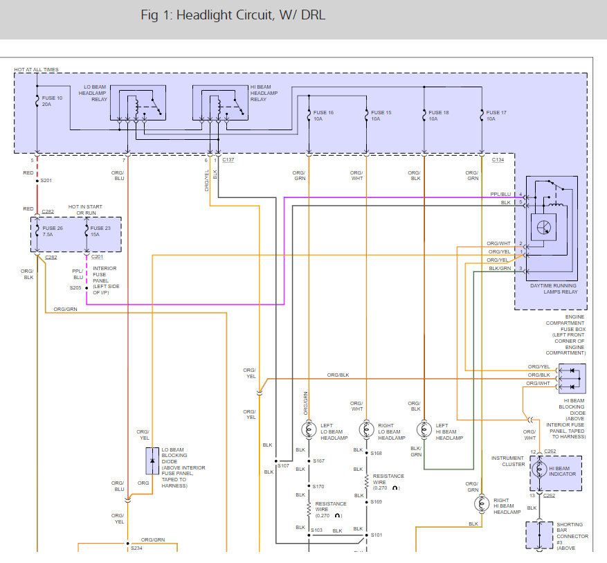

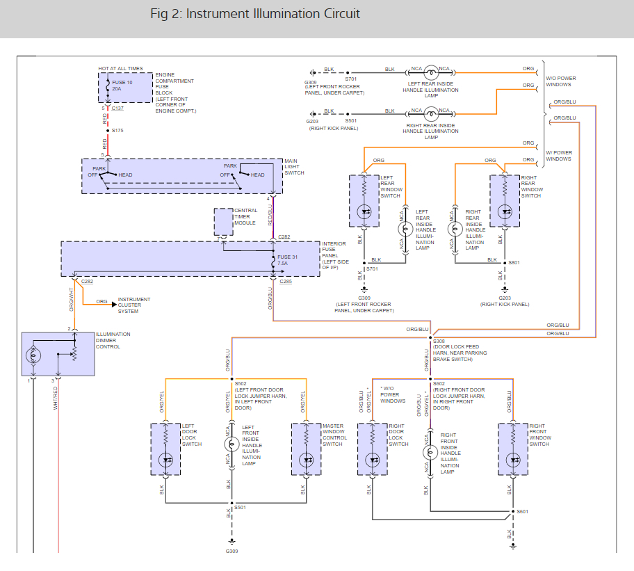

1997 Ford Contour, the running lights, dash lights and license plate light do not work. The brake lights and headlights do work. I've replaced all the fuses and fuse box, headlight switch, and double checked that all the bulbs are good, yet still no running lights.
Aug 5, 2010 at 4:48 PM
LEGITIMATE007
  • 5,121 POSTS
check the dimmer switch, also be sure that the dimmer switch isn't off or all the way down low. Check the drl relay. Usually located right at the headlights.
Aug 6, 2010 at 3:03 AM
DAVID GUSHUE
They are stell not working
Jan 6, 2018 at 8:52 AM
  • 55,663 POSTS

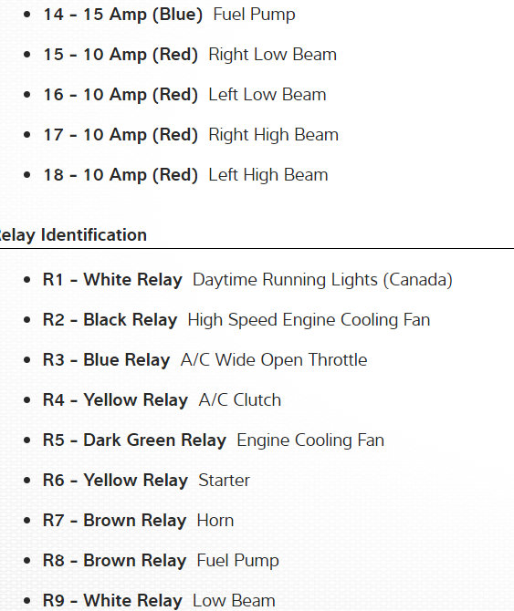

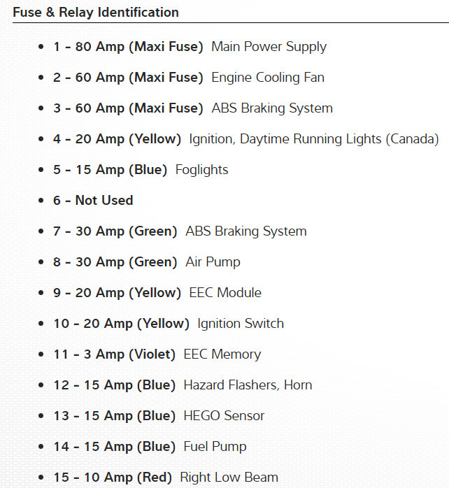

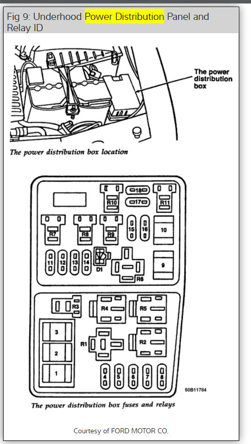

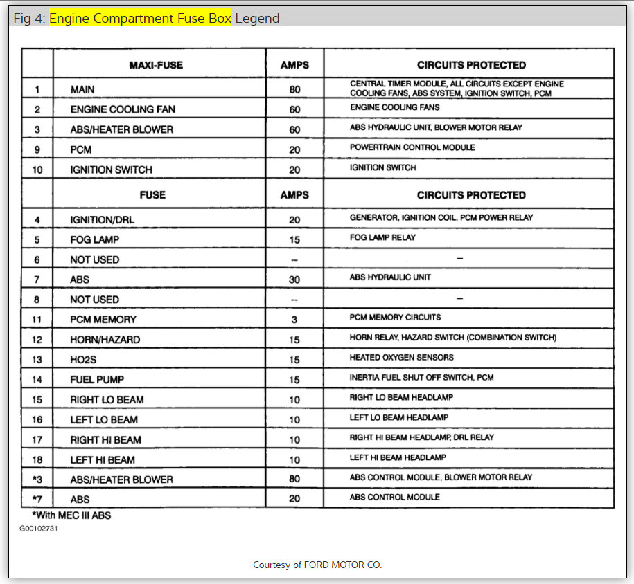

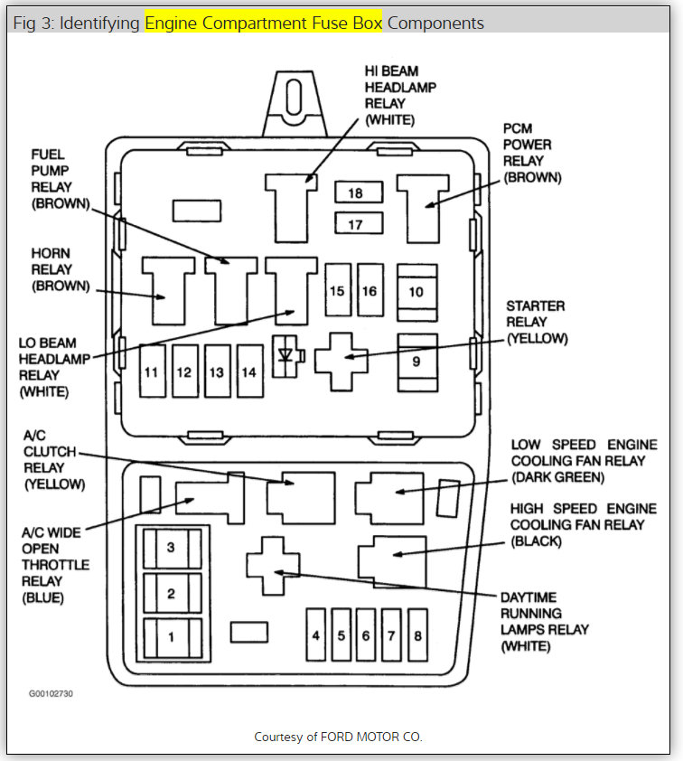

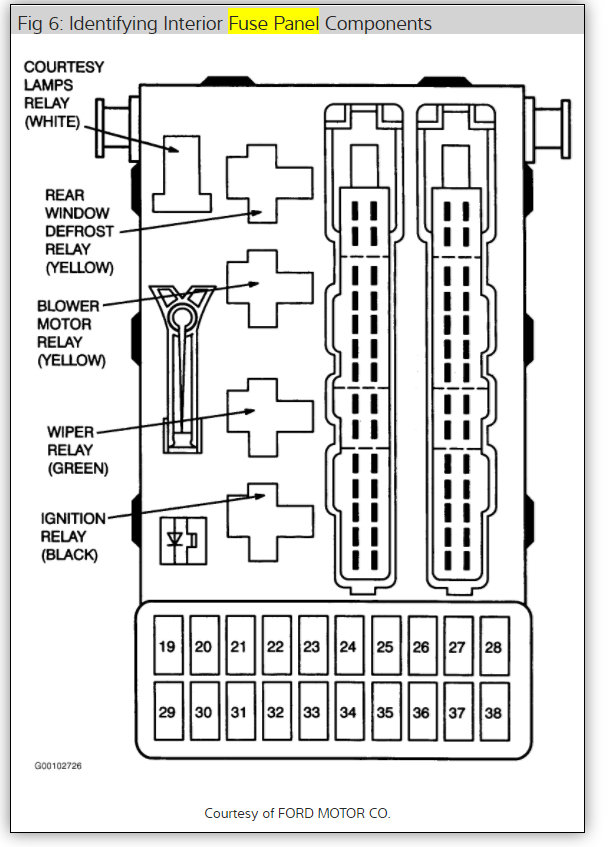

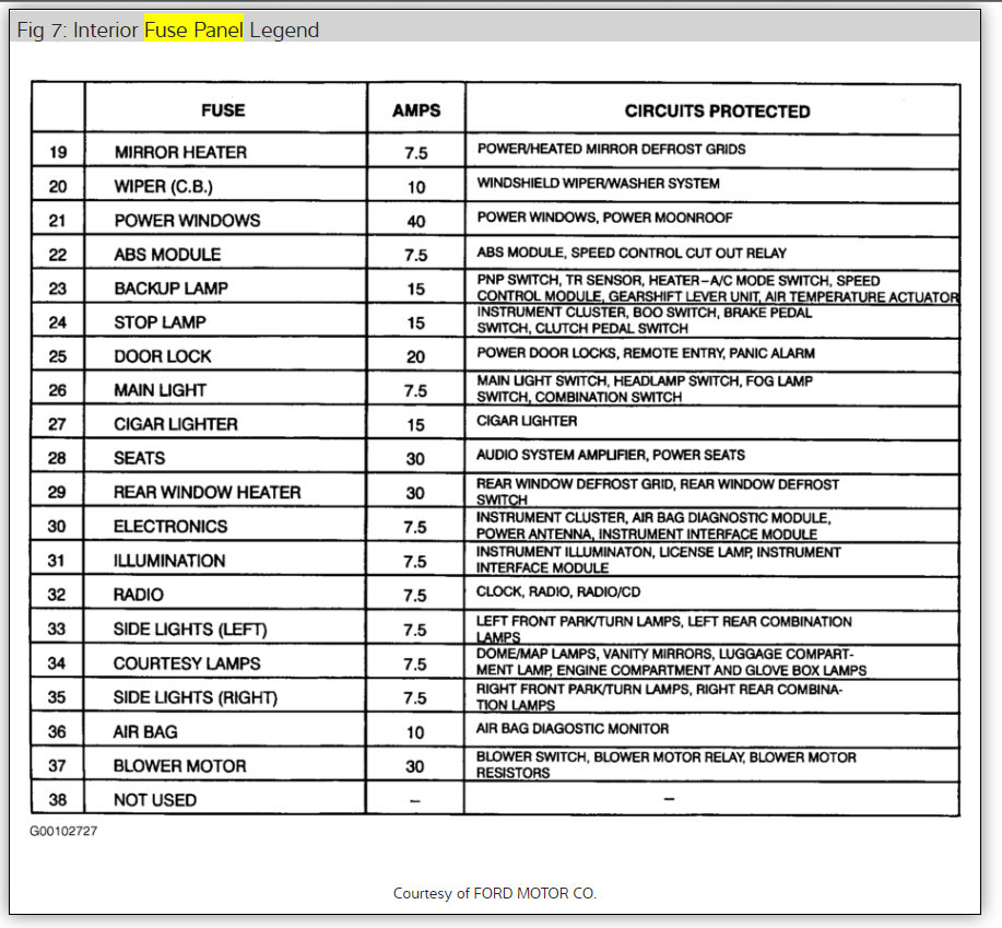

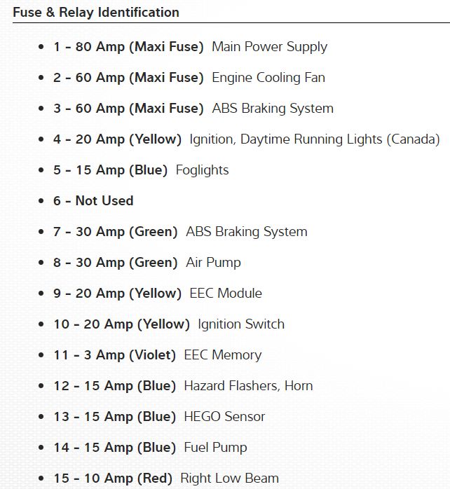

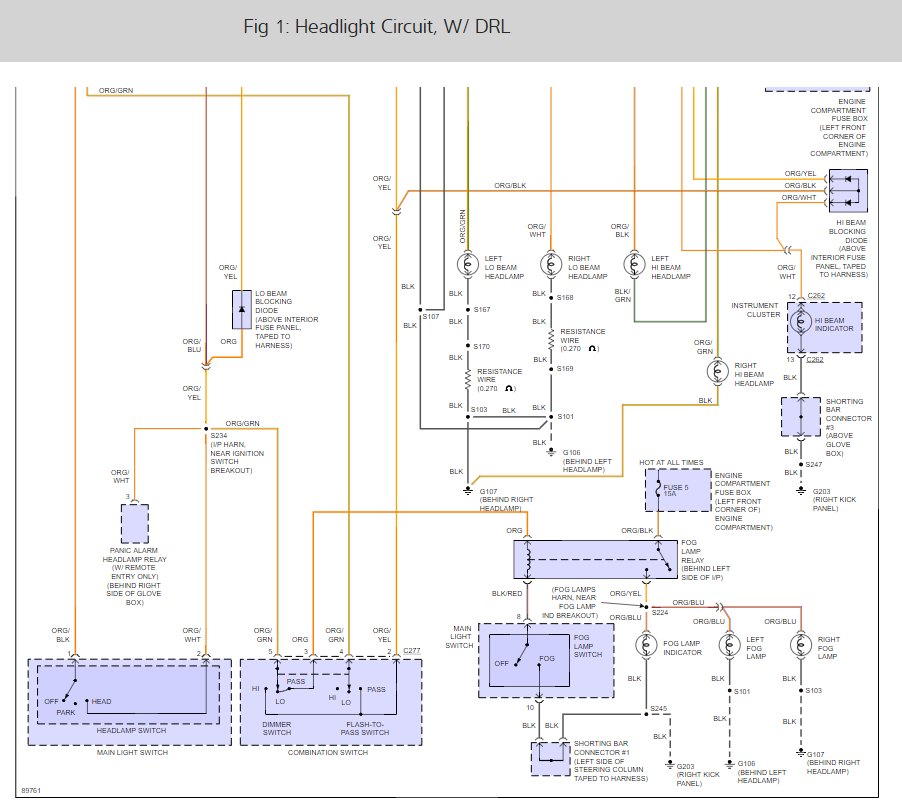

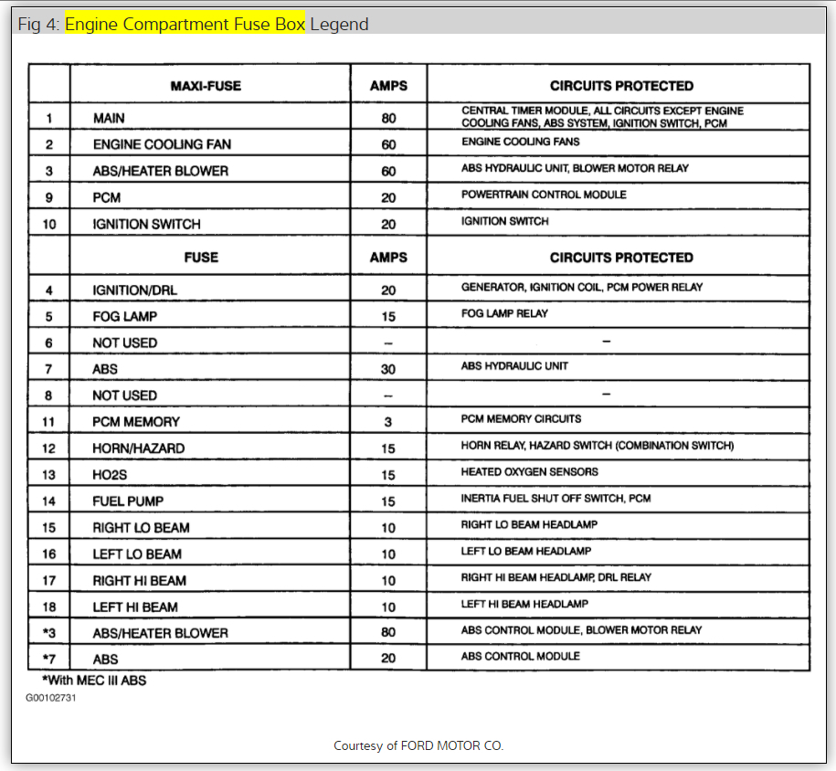

There is a fuse #10 20 amp fuse that may have gone out which powers the circuits in question. Here is a guide to help you start testing.

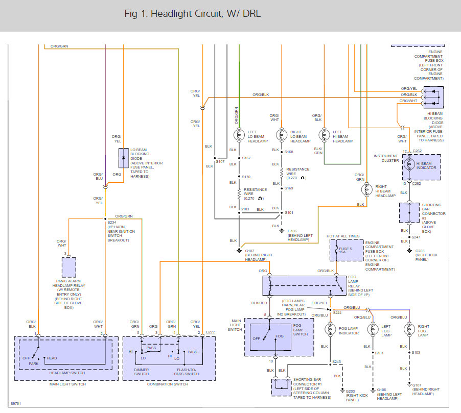

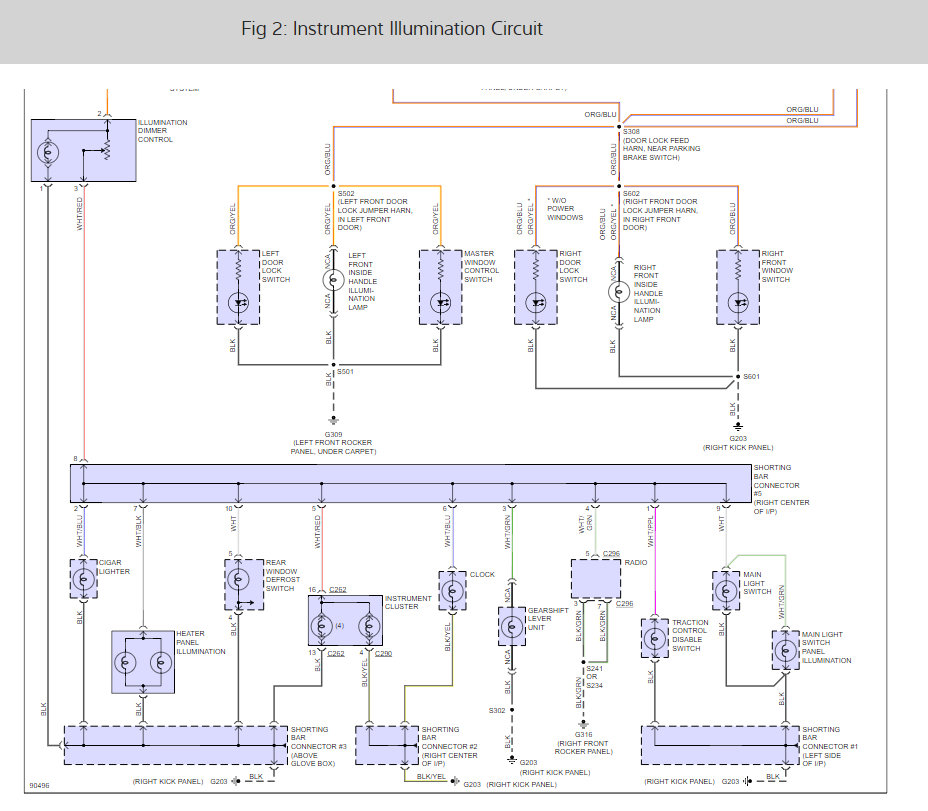

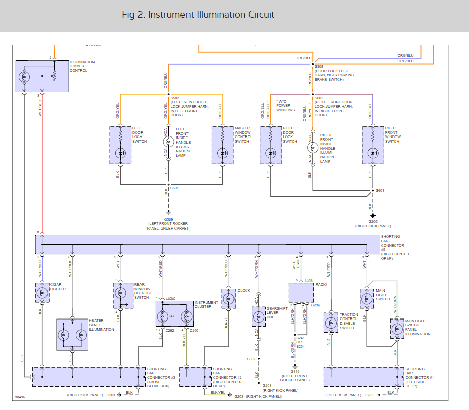

Here are the headlight and running light wiring diagrams with the instrument cluster wiring as well so we can see how the system works.
