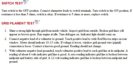

> Just have a couple of qustions for you,
> 1) how would I fix my rear defrost if the light comes on but no defrost is working?

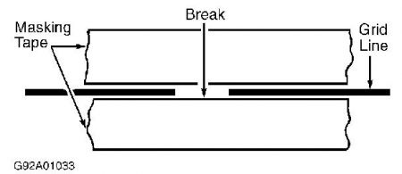

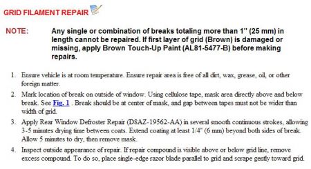

Hello 1.) Probably broken grid filaments. May also be faulty switch. Perform folllowing tests to pinpoint and repair culprit.
https://images.2carpros.com/forum/automotive_pictures/261618_Noname_143.jpg
https://images.2carpros.com/forum/automotive_pictures/261618_Noname2_50.jpg
FIGURE 1
https://images.2carpros.com/forum/automotive_pictures/261618_Noname_144.jpg
