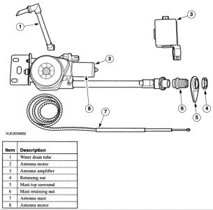

my antenna is powered by a motor and ive taken that part out. now all i want to do is take therest of it out, which is just the part that stick outside out the car and the rod inside. how do i get that out?

There is a nut with slots in it at the base of the mast, against the outside of the qtr panel that has to be unscrewed and it will all drop out from the bottom.
