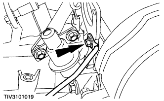

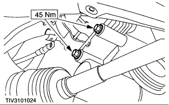

HOW DO I REMOVE THE ALTERNATOR. FROM THE BOTTOM.

I have provided the info on removal and replacement.
REMOVAL
https://www.2carpros.com/forum/automotive_pictures/248015_1_36.gif
Disconnect the battery ground cable.
https://www.2carpros.com/forum/automotive_pictures/248015_2_42.gif
Remove the intake air resonator.
Disconnect the air cleaner outlet tube.
Remove the bolts and nuts.
Remove the resonator.
Disconnect the vacuum pipe underneath.
https://www.2carpros.com/forum/automotive_pictures/248015_3_31.gif
Disconnect the generator wiring.
Remove the nut and disconnect the cable.
Disconnect the electrical connectors.
https://www.2carpros.com/forum/automotive_pictures/248015_4_22.gif
Disconnect the ground cable.

Remove the accessory drive belt.
https://www.2carpros.com/forum/automotive_pictures/248015_7_7.gif
NOTE: The lower bolt cannot be removed until the generator is repositioned.
Remove the generator lower retaining bolts.
Lower the vehicle.
https://www.2carpros.com/forum/automotive_pictures/248015_8_8.gif
Remove the generator upper retaining bolt.
https://www.2carpros.com/forum/automotive_pictures/248015_9_7.gif
Lift the generator clear of the engine. CAUTION: There is a very limited amount of space in which to remove the generator. Do not overstress or damage any hoses or cables.
