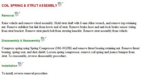

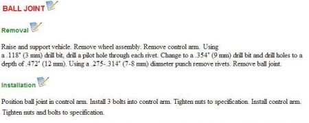

how hard is it to replace front struts and springs and ball joint?I'm just a small time back yard mechanic.
