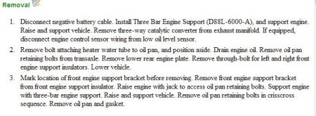

i have a 1996 ford contour. How do i remove the oil pan to replace the gasket?

Hi there, See text for sump removal. Mark (mhpautos)
https://images.2carpros.com/forum/automotive_pictures/61395_1_85.jpg
