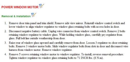

How do I get the front window off the the regulator

https://images.2carpros.com/forum/automotive_pictures/261618_Noname_1742.jpg
