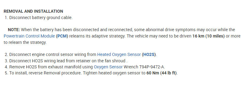

On my Ford Contour the check engine light is on and they say the oxygens ensors are bad I need to find them.

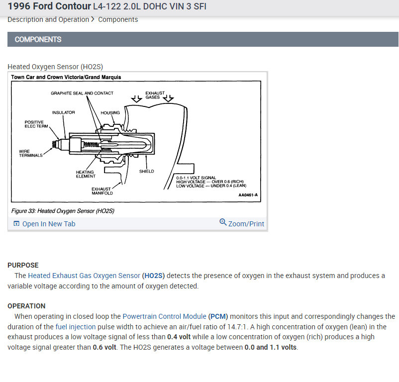

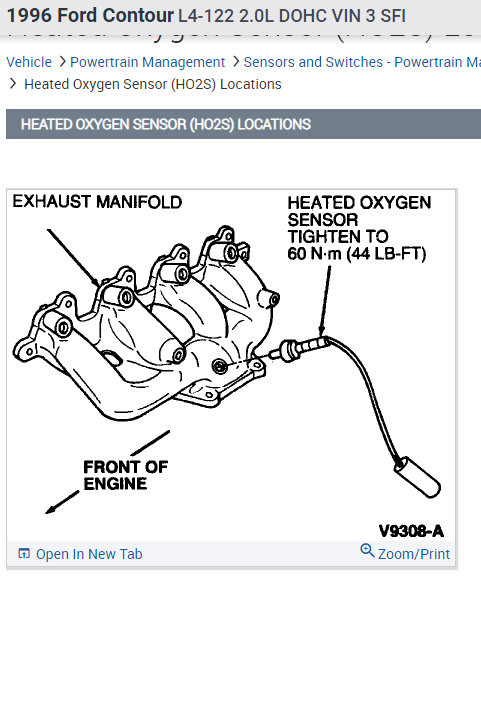

Replacing an oxygen sensor can be done using simple hand tools.
Your vehicle has 2 oxygen sensors. One before the catalytic converter, in the exhaust manifold. Second one after the catalytic converter.
When you runs the scan for codes it usually tells you which one is bad (or both).

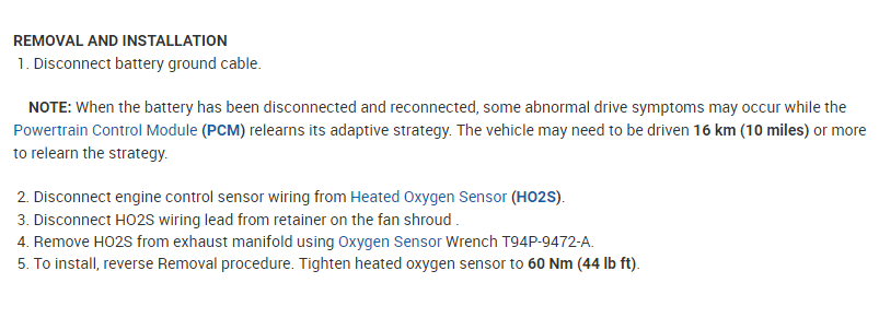

I have attached the replacement procedure for your vehicle.
