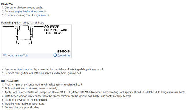

I have a problem with my car It won't start fuel injectors are firing it will crank but wont start have checked sensors all good any help???
Dec 8, 2007 at 7:36 AM
BLACKOP555
  • 10,386 POSTS
are you getting spark at the #1 spark plug? and are you getting between 40-50 pounds of fuel pressure at the fuel rail?
Dec 8, 2007 at 10:07 AM
  • 55,837 POSTS

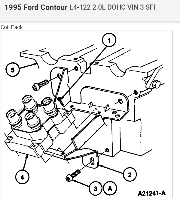

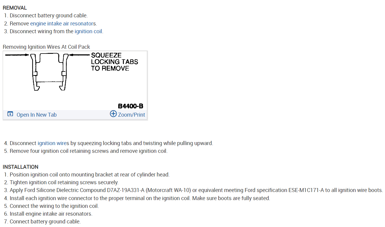

I have seen the ignition short out and cause this problem, here is the location and how to swap it out which should fix it. Check out the images (below). Let us know how it goes
