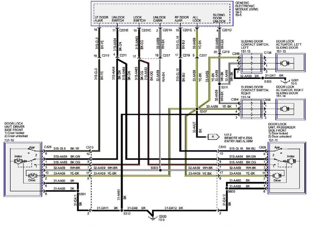

hello i need 2T1T-15K600-CD gem module wiring diagram. my car remote control stopped working, interior lights do not work and when i open the door with the key the alarm beeps for 30 seconds, the fuse is good, what else should i check?
May 11, 2025 at 7:16 AM (Merged)
  • 55,808 POSTS

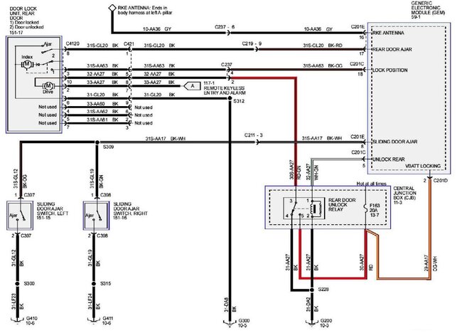

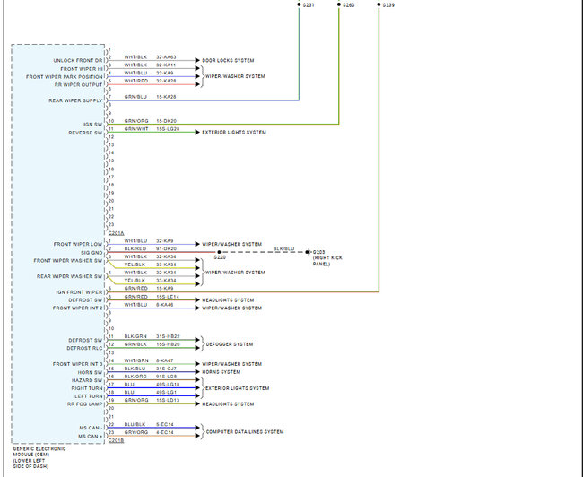

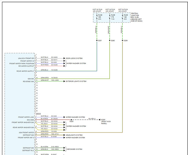

I would do a CAN scan to see if there are any codes for the GEM, here is a video to show you how:
https://youtu.be/u-4syLc-ifQ
Here are the wiring diagrams needed to help see how the system works. Check out the images (below). Let us know how it goes.
May 12, 2025 at 1:52 AM
STEVE W.
  • 15,421 POSTS

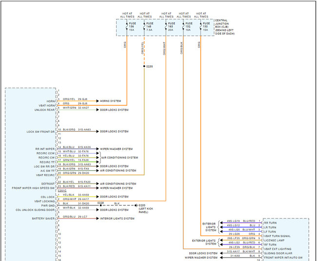

The Transit Connect didn't come to the US until 2010 which is still the first-generation unit so these diagrams for a 2010 should be close to what you have. From the description it almost sounds like a bad GEM. What you might try is to disconnect the battery, wait 10 minutes and reconnect. See if the module resets. If not, then you will need a proper scan tool that you can use to test the system. Also use the manual key to lock and unlock the doors one at a time and see if anything changes.

My 16-year-old car's remote control stopped working for the first time. I've been dealing with this for a week and the alarm goes off when I lock and unlock the car. I've changed the remote control battery 3 times and checked all the fuses, no problem. I think the problem is in the gem module, so I asked for a schematic. What else should I do? As far as I know, my car model doesn't have a receiver antenna. Am I wrong? What should I do?
May 16, 2025 at 3:34 PM
STEVE W.
  • 15,421 POSTS
It has an antenna. Plugs into the remote entry module. You need to go to the GEM and check the powers and grounds as shown in the earlier diagrams. If the powers and grounds are okay but the module isn't working correctly you get a new GEM and program it for your car. If you are looking for a board level schematic IE you are taking the module apart to repair the actual board, those are not available.

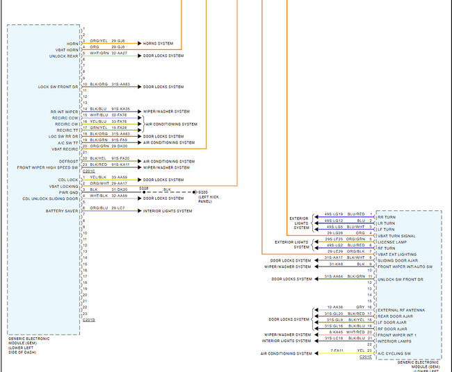

If the module receiver antenna is intact, I will do what you say. Where is the receiver antenna of my vehicle? In the photo I sent in the attachment, it says that the gray cable coming out of the gem module is the antenna. I can't find where this gray cable goes, I want to see if the receiver is intact. Does this gray cable go to the remote entry module?
May 17, 2025 at 1:07 AM
STEVE W.
  • 15,421 POSTS
The antenna is inside the harness, not external. It runs from the module up toward the A-pillar.

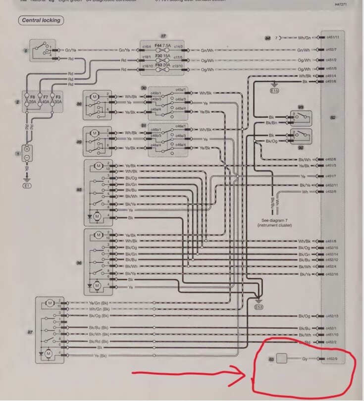

I can't find the remote control antenna. I need to check if it's good. If it's faulty, I can buy a new module for this one. Please show me where it is with a picture. 2008 ford connect gem module remote control receiver.
May 17, 2025 at 10:30 PM
STEVE W.
  • 15,421 POSTS
It is nothing but a grey wire that comes from terminal 16 and runs up through the harness to the front of the car. A simple test is to go to the module itself and try the remote right next to it. If it doesn't work the module is suspect because at that range the antenna isn't needed anyway. Plus, I doubt it is the antenna because it only increases the range you can get away from the vehicle.
