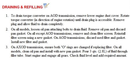

1990 Ford Capri 4 cyl Front Wheel Drive Automatic
Hi, i have purchased the transmission repair kit for my Ford Capri and i just need a guide of how to reflace the filter. This is the first time replacing a transmission filter.

https://images.2carpros.com/forum/automotive_pictures/261618_Noname_2156.jpg
