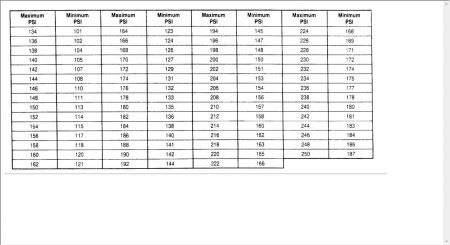

new wires, new injectors... what should the compression be?
Mar 5, 2010 at 8:21 AM
  • 75,988 POSTS
https://images.2carpros.com/forum/automotive_pictures/12900_compression_2.jpg
Compression pressures are considered within specification if the lowest reading cylinder is within 25 percent of the highest reading cylinder. NOTE: Variations exceeding 25 percent indicate an improperly seated valve or worn/broken piston rings.
