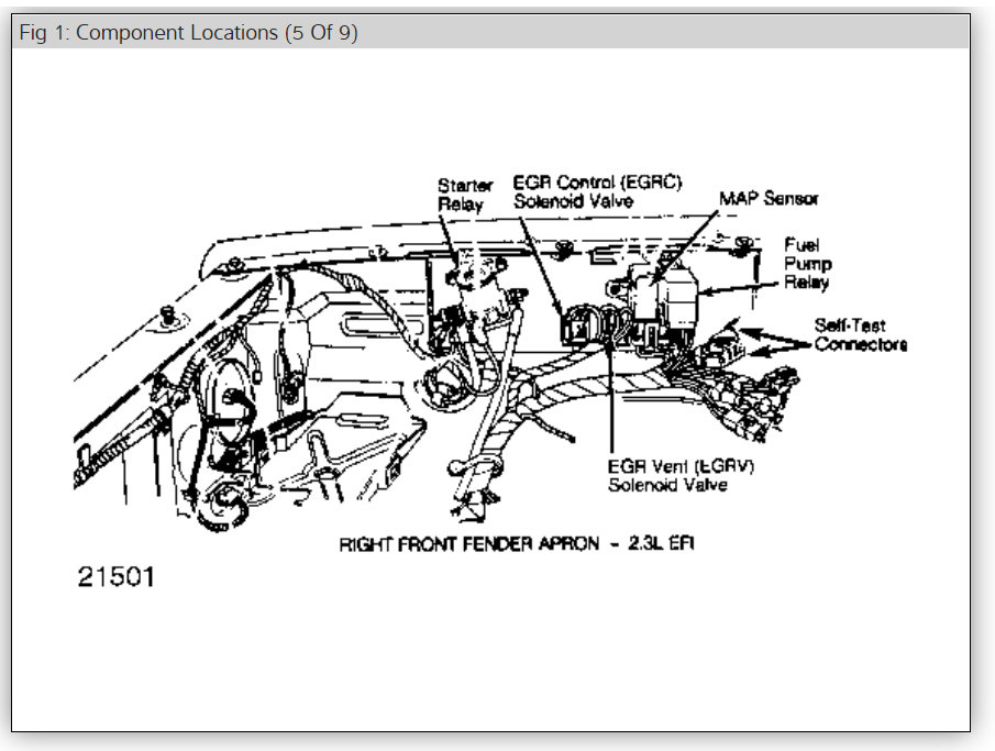

ROCOCO71
Where is the EGR valve located on the vehicle listed above Bronco 2?
Jul 17, 2020 at 12:05 PM (Merged)
DAVE'S BIG BACKYARD!
  • EXPERT
  • 262 POSTS
i have never seen a egr stuck closed that would make the engine run rough, now if it stuck open then it might not even idle at all,as far as hi combustion temp yes this is true but it only rises under a load or constant hi idle and when this happens it makes this sound we old timers like to call spark nock,this is what an egr gets rid of.keep in mind this is a 1989 truck.
CJ MEDEVAC
  • CAR REPAIR CONTRIBUTOR
  • 11,004 POSTS
It's up on the intake manifold. It will look like one of these animals in my picture below!
