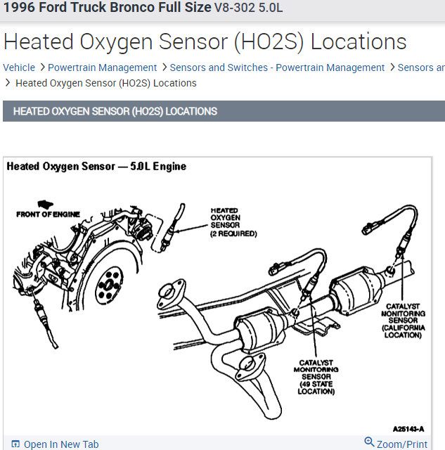

I was told the problem is probably the o2 sensor has gone bad. Could this be the problem? Is there more than one sensor in the converter for this year model Bronco? Thank you.

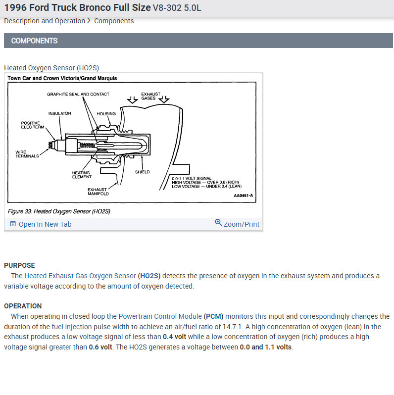

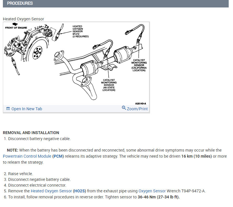

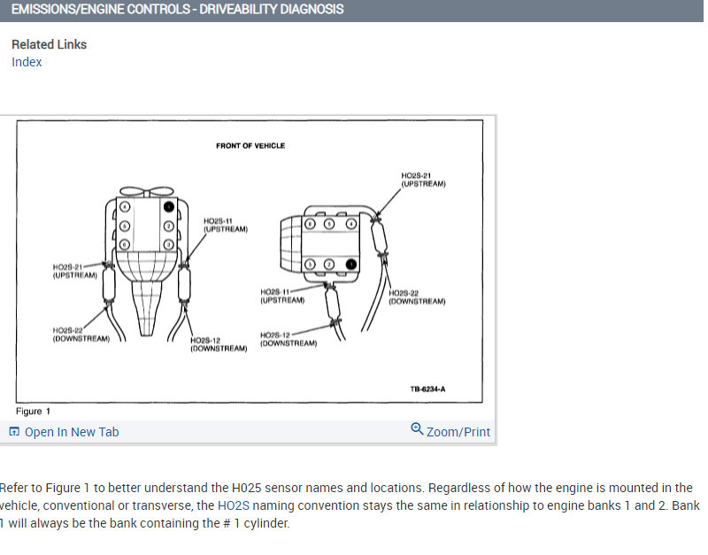

This vehicle can have up to 4 O2 sensors, depending on the emission standard.
Here is a helpful article:
https://www.2carpros.com/articles/how-to-replace-an-oxygen-sensor
I have attached the location diagram as well as replacement procedure.
Let me know if you have any questions.
