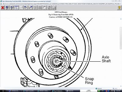

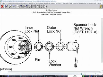

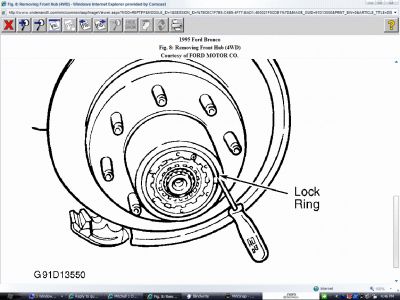

we are trying to replace the rotors on my 1995 ford bronco but it has auto lock hubs and we are having a hard time gettin them off to take the rotor off

First, remove the 5 Torx T25 screws, then pull the cap off, try not to drop the spring and stuff under it, then Remove the snap ring on the axle shaft, and the lock ring on the outer edge of the hub. Use a Spanner socket, designed for 4X4 lock nuts, remove the first nut, Then remove the lock ring, then the inner nut with the pin in it...Pull rotor off!
