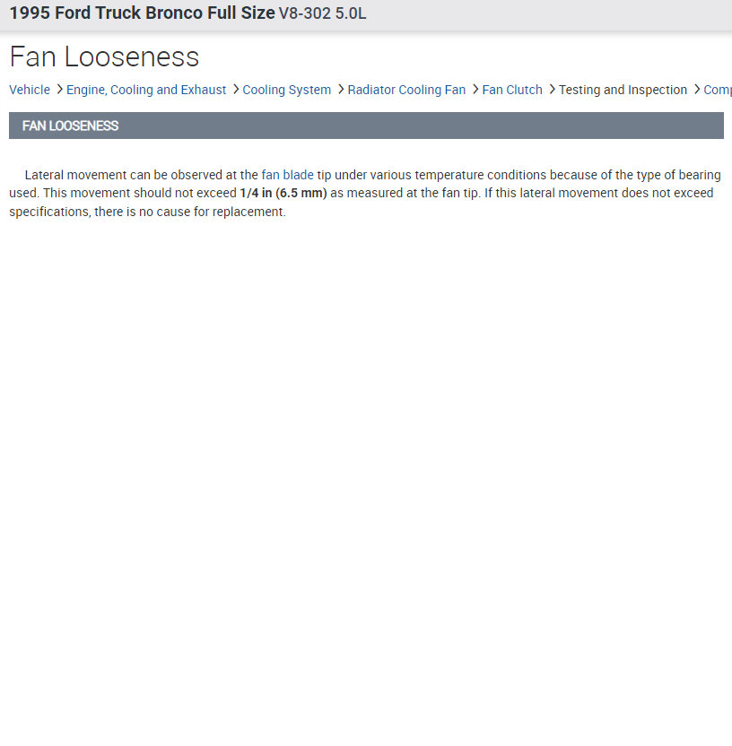

The fan clutch should have a little lateral movement. But it should not move more than .25" at the fan tip. Any more than that is a sign of a faulty clutch.

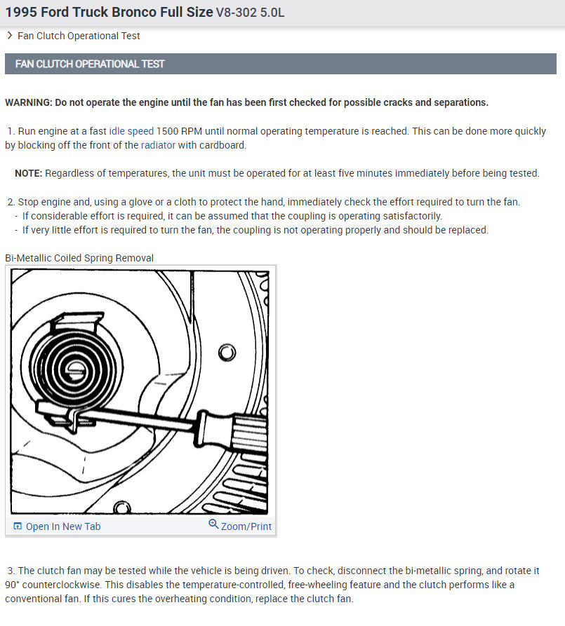

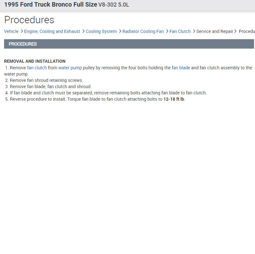

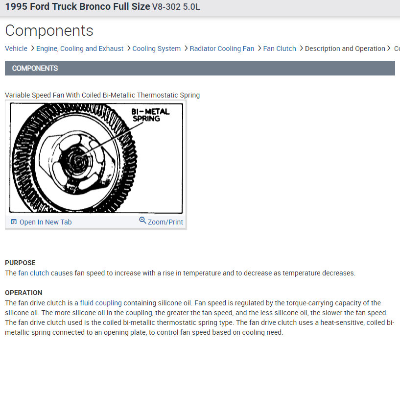

I have attached few helpful info on the fan clutch as well as the replacement procedure.
