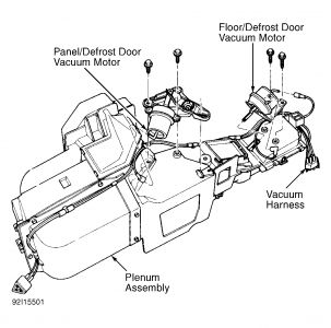

How do I replace my heater core?
Jan 31, 2009 at 1:04 PM
DAVE H
  • 13,384 POSTS
HEATER CORE Removal & Installation Drain cooling system. Disconnect heater hoses. Remove glove box for access. Remove 7 screws attaching heater access cover to plenum. Disconnect vacuum source. Leave vacuum harness attached to cover. Remove cover. Remove heater core from plenum. To install, reverse removal procedure.
https://images.2carpros.com/forum/automotive_pictures/266999_core_2.jpg
