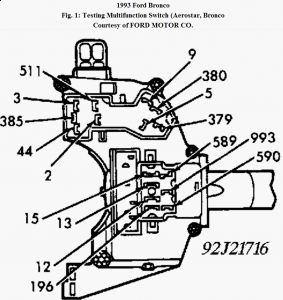

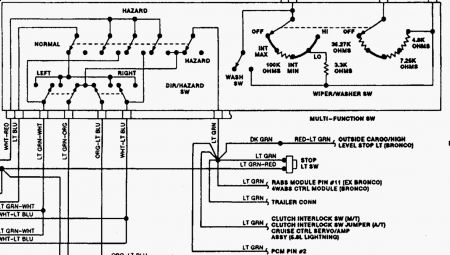

When I use my left turn signal it shuts the cruise off like you hit the brake.If you hit resume it comes back on.I have looked for rubbing or bad wires ,I can't find the problem.Thanks
Mar 13, 2010 at 4:22 AM
MERLIN2021
  • 17,250 POSTS
The cruise servo power ties into the multifunction switch very close to the directional signal terminal, test/replace the multifunction switch.
https://images.2carpros.com/forum/automotive_pictures/62217_cruiseservo_1.jpg
https://images.2carpros.com/forum/automotive_pictures/62217_multifunction_switch_1.jpg
I will email the test procedure.
