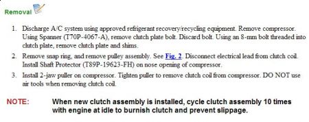

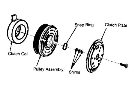

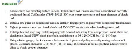

How is the A/C compressor clutch removed?
Sunday, June 21st, 2009 AT 4:27 PM
BLUELIGHTNIN6
MECHANIC
16,542 POSTS
FIGURE 2
