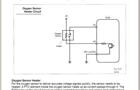

See below how Heated Exhaust Oxygen Sensor is wired in -
https://images.2carpros.com/forum/automotive_pictures/12900_ox_1.jpg
Feb 2, 2008 at 5:41 AM
BRONCOLOVER
  • 15 POSTS
Ok, i know you're only trying to help, and I'm sorry, but I have no idea what that is showing me. I see it says heated o2 sensor and ground symbols but that really doesn't show me which wires go where. I'm trying.
Feb 2, 2008 at 8:33 AM
  • 75,992 POSTS
Hook the white wire that has power on the heater circuit the other wire should go back to the computer. Or trace the wires back to the computer and determine which is the ground between the two.

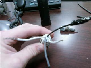

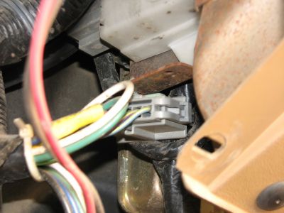

Pictures!
https://images.2carpros.com/forum/automotive_pictures/84549_1_1.jpg
That's the O2 sensor side. the grey and black wire have been taken care of, no problem there. Like I said it's the white ones that are giving me the problem.
https://images.2carpros.com/forum/automotive_pictures/84549_2_1.jpg
That's what I plug into the connector on the bottom of the engine. There are no markings of any kind on these two white wires, though they were connected to the ones on the O2 sensor, I cut them all because the solder I have is a butane torch that was melting the wires while I soldered the other and I was stupid enough not to mark them. I just need to know if it would matter if I hooked these to the ones coming out of the o2 sensor backwards or if I'm really lucky it would be like before I cut it and get it right. I just don't want to have wasted $50 to have to do this again.

Well after all this time and hassle I found it. Though it's not the exact same one for my truck, but it's the same design and the same simple answer.
* Since there is no polarity to the heaters, it is only important to match the color of the heater wires.
So I'll just finish wiring it and have it put in and hopefully that will solve the c.e.l. and the gas mileage. Thank you for your help I will be donating as soon as I get my paycheck. Thanks again!
Feb 2, 2008 at 3:50 PM
  • 75,992 POSTS
That's why I gave you the diagram-the heater has a resistor so either way it would worked. I'm glad you sorted all out-Good Luck
