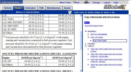

What is the fuel pressure supposed to be at with key on engine off on 302* 5.0L???

You sure its not a 302CID instead of 305 See chart below

yeah sorry i was half asleep when i wrote that question i meant 302 5.0L
