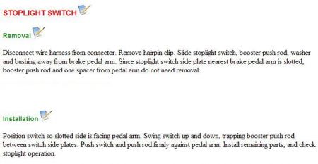

1992 Ford Bronco (full Size) Has a brand new brake light switch but the brake lights dont work until you around half way down.
1 Can this switch be adjusted?
2 If so how?

ensure it is installed correctly using steps below
https://images.2carpros.com/forum/automotive_pictures/261618_Noname_1766.jpg
