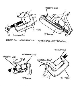

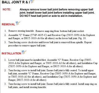

1992 Ford Bronco V8 Four Wheel Drive Automatic
is there a step by step on how to remove and install ball joints.
