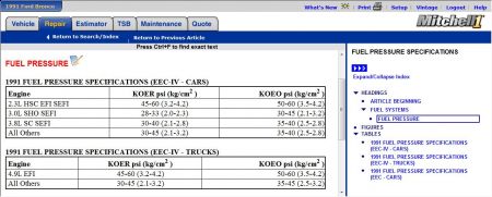

The only way to rule out the fuel pump is you have to check the fuel pressure with a fuel pressure gauge designed for your fuel system.
EFI system don't like low fuel pressure-could be a leaking fuel pressure regulator or injectors.
https://www.2carpros.com/forum/automotive_pictures/12900_fp_11.jpg

Get a fuel pressure tester hook it up on the fuel pressure test port/schrader vale turn key to run and read off the pressure use specs above and then comeback with the readings
****3) Overnight fuel line pressure test (which stayed in proper PSI range) - maybe I need to do more extensive fuel pressure tests? ****
Do you hear the fuel pump come on when you turn key to run? If so do the fuel pressure test if not investigate and test the fuel pump relay and pump fuse, inertia switch.
Thursday, August 27th, 2009 AT 10:35 AM

Here are my readings and answers:
1) Pump is priming OK (when ignition is turned to ON position).
2) Connected pressure to shrader valve and results are as follows:
-- Ignition in ON position: 35 PSI (pump primes OK)
-- Engine running: 32 PSI
-- Turn off engine: 35 PSI (stays steady at this)
I noticed I might have not had my fuel filter clamped very well when I checked it today, and so secured it properly.
I am going to run the tests in the AM again just to see if the fastening of the fuel filter might have been the issue all along.
Remember the only issue is when I start up the engine on a cold start (after sitting overnight), it needs to crank 8-10 times before the engine fires up. Maybe the fuel filter was hanging in such a way that the fuel was dropping backward and holding in the filter instead of staying in line. Anyhow will check in the AM to see if the 8-10 cranks is still happening.
