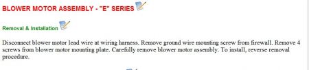

How can you remove a faulty blower motor and replace it with a new one? Does the entire dash need to be removed? Or can you go through the engine compartment?

Hi there, Thank you for the donation, Mitchell 1 has this as the removal procedure for the "E" model,
https://images.2carpros.com/forum/automotive_pictures/61395_Capture_29.jpg
