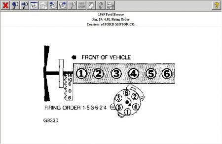

I changed out the engine in my Ford Bronco II and am not sure what the correct timming should be. I found a site that suggested a 12 degree advance. Is this correct? Also is the timming set to the pointer or the hole in the pointer?

Its 10deg BTDC -you need to use a magnetic timing probe to set timing in the hole-Your shot on the pointer-
https://images.2carpros.com/forum/automotive_pictures/12900_timing_11.jpg
