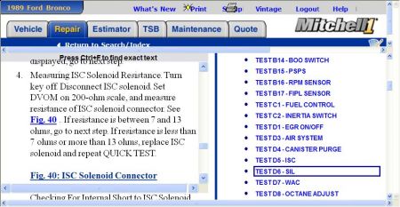

Also I checked the idle speed control: it had 10-10.5v, the motor resistance was closed, the book said 7-13 ohms. When I unplug it with the engine running it stalls out.

Recheck the ISC solenoid
https://images.2carpros.com/forum/automotive_pictures/12900_isc_solenoid_1.jpg

Sorry wrong info again. first time only had a needle ohm meter.
When rechecked with a DOVM set on 200 I got 9.5 resistance.
