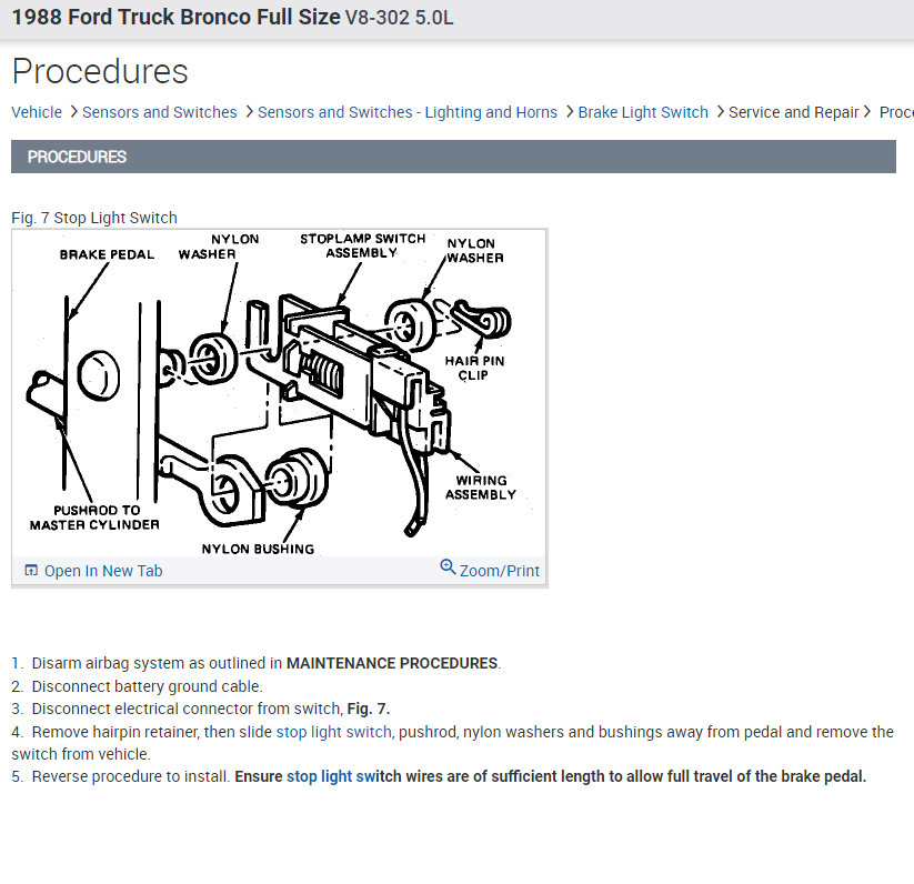

Brake lights will not work all other lights work new brake switch bulb is also new what else could it be other than the fuses

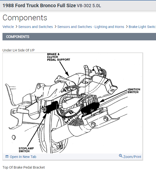

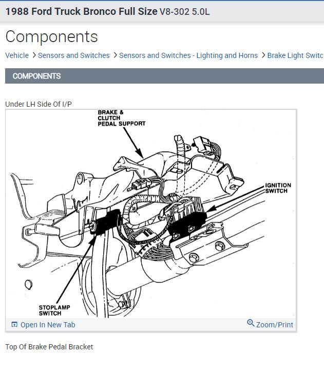

It sounds like you have a faulty brake light switch.
The brake light switch is what turns on the brake lights when you depress the brake pedal.
That switch is located on top of the brake pedal bracket.
You might find this information helpful:
https://youtu.be/RBCDVfzNQGk
I have attached the diagrams for your reference.
