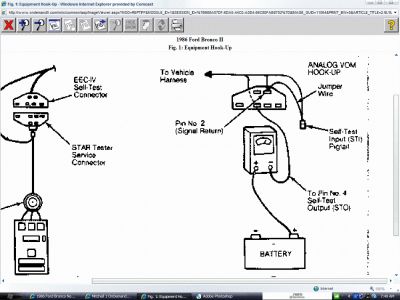

Mike is the check engine light on? Or ever flash when you are having trouble? If so you might want to read them. If you locate the test connector, it has two connectors, a 1 pin and a multi pin connect the upper right pin to the single pin with a jumper and count the flashes on the dash ligh with the key on. But it does sound like a MAP sensor problem.
Saturday, December 1st, 2007 AT 2:24 PM
POPEYE46
  • 9 POSTS
Thanx for your quick reply. I am not sure if there is a "check engine" light but the emiss light did come on for awhile and then went off and has not been back on again. I have a repair manual but it does not mention anything about the trouble codes or where to place the jumper to find them.I have checked for a code reader and I cannot find one for the 2.9. They do have one that will read the 2.8 but not the 2.9. Don't understand that one.I have noticed a connector under the hood that has a cover inserted in it but have no clue what it is. Again the manual does not tell me what it is. The manual also does not cover the emission sensors very well, gives name and location but nothing else. Will try the map as you suggest and look for the connector to jump for the trouble codes. What code am I looking for? Thanx again for your quick reply and I will let you know what I find. Mike
Sunday, December 2nd, 2007 AT 5:40 AM
MERLIN2021
  • 17,250 POSTS

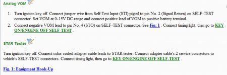

Look for these two connectors, they are on the drivers side inner fender I think...Hook up to an analog voltmeter this way...
https://www.2carpros.com/forum/automotive_pictures/62217_Code_Reading_1.jpg
https://www.2carpros.com/forum/automotive_pictures/62217_Code_Reading1_1.jpg
https://www.2carpros.com/forum/automotive_pictures/62217_Code_Reading2_1.jpg
https://www.2carpros.com/forum/automotive_pictures/62217_Code_Reading3_1.jpg

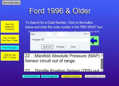

A code 22 is what I think youll get, thats the MAP...

Found the two connectors. Located down by the heater motor on the passenger side. Jumped the single to the top right and turned on the key. Emiss light came on when I turned the key on and then went out and did not come back on at all.I know on my celebrity it will blink a 12 just to let you know that it is connected and then blink the trouble codes. Does this do anything similar? Found the MAP sensor by following the vacuum diagram under the hood. Is there anyway to test this sensor or do you just replace it and could it be bad and still not give a code or could there be a problem with the ECU preventing it from giving codes and causing the problems that I am having. Thanx again for your quick and helpful responses. Have a nice day. Mike
Sunday, December 2nd, 2007 AT 12:38 PM
POPEYE46
  • 9 POSTS
Need to apologize, reread your last answer and I tried with a digital meter. Duh, at 61 I am subject to brain farts. Will get a analog meter and try again. Small print was not working on the old eyeballs. Really want to figure this one out. Becoming an obsession and at my age that is not good. LOL thanx again for your speedy and informative replies. Again have a nice day. Mike
Sunday, December 2nd, 2007 AT 1:05 PM
MERLIN2021
  • 17,250 POSTS
Mike you can try unplugging the vac line and use a vac pump, see if it leaks or holds!
Sunday, December 2nd, 2007 AT 2:17 PM
POPEYE46
  • 9 POSTS

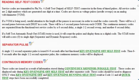

Good morning again, I took the vacuum line off of the MAP sensor and checked it with a pump. It held vacuum. Also got a analog VOM and tried jumping the test leads according to the diagram that you provided. Thanx for that>>>> I am not sure if I am reading the meter right. When I turn on the key it goes all the way to the left side.I can hear a click and it will drop a little and then return to the left side. Now it will drop to zero and pulse 2 times up and down. The third time it stays all the was to the left again for a second or two then it will return to zero and pulse up and down again this time 4 times and then on the fifth one it will stay all the way to the left again for a couple of seconds. If I write all the times that it pulses I get a 2 - 3 - 1 - 4 not in that order in between the times that it stays all the way to the left. I am not sure if it stays to the left in between numbers or not.I am not sure about the explanation in the diagram that you sent.I feel like I am getting to be a pain but this is really driving me nuts. Thanx again for all the help and have a nice day.I know that it pulses I am just not sure why it stays all the way to the left side of the meter. It will do this two or three times in a row. Stay there drop to zero then go all the way to the left side and stay there again. No pulses in between. Mike
Monday, December 3rd, 2007 AT 3:23 PM
MERLIN2021
  • 17,250 POSTS
If we cant get the meter to operate, the readers for this year are dirt cheap, like 20.00 bucks, It seems there are codes, if we want em we need to go get em. Or take a shot in the dark with the MAP.

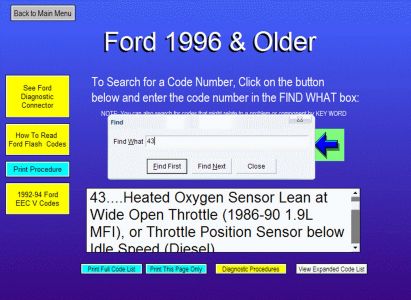

I would like to thank you for all your kind and patient help......I finally figured out the VOM and it is giving me the codes 22 and 43 I now know what 22 is do you happen to know what 43 is.......again thanx and have a nice day........Mike
MAP=22
https://www.2carpros.com/forum/automotive_pictures/62217_Codes22_1.jpg
https://www.2carpros.com/forum/automotive_pictures/62217_Codes43_1.jpg
Replace the MAP
