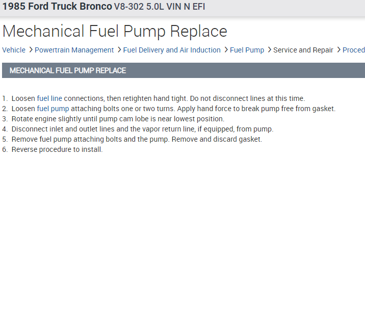

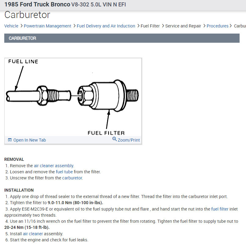

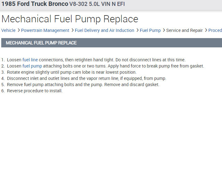

It sounds like you might not be getting enough fuel.
That's why it starts but then stalls.

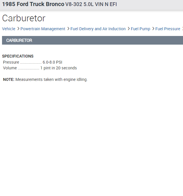

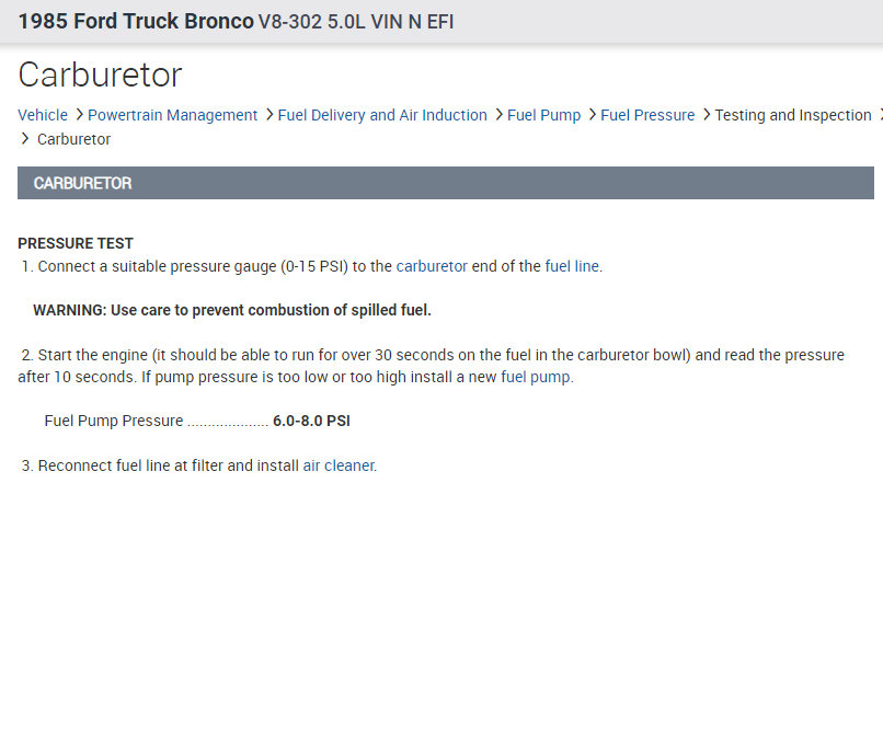

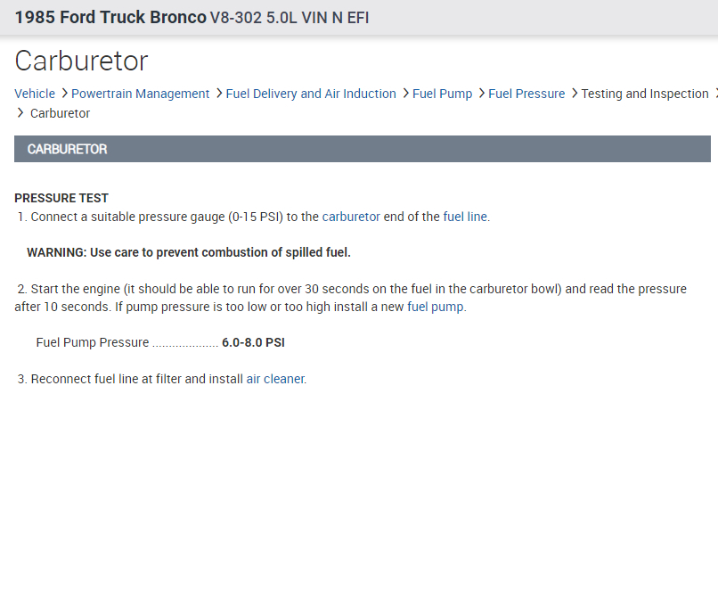

Check to see if it has adequate fuel pressure as well as it is producing the correct volume.
You should have 6-8 PSI of fuel pressure and it should produce 1 pint of fuel every 20 seconds.
https://youtu.be/aITQclp7zIE
If you do not have adequate fuel pressure or volume, make sure the lines are clean. A clog in the fuel filter can cause this. It can also happened due to a weak fuel pump.
